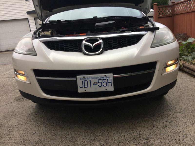

There is a simple way to have the fogs come on with ignition power.
My write-up: Fog_Lights
Thread from other forum: https://www.mazdas247.com/forum/inde...-on.123685451/
A detailed PDF from the above thread: http://chrisb.users.superford.org/Ma...s/CX9-DRLs.pdf
I did the heated seat method and it works perfectly; fogs go on/off with the ignition. They are still grounded by the headlight switch, so will turn off when the hi-beams are turned on.
You can also tap into the park light circuit instead of the seat circuit if you want the fogs always on with the park lights. There is chatter of this method in the thread above.
