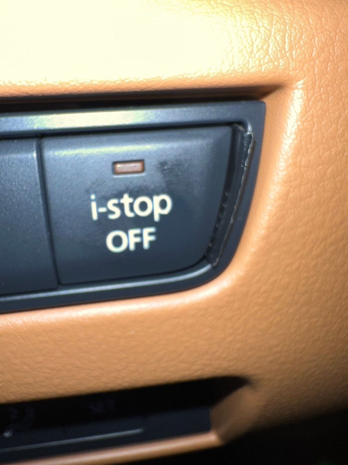

Here is a easy fix for the i stop.This involves wedging a piece of plastic between the i stop button and the dash, on the right side.
1. Start engine
2. Push button in and hold it, orange light will appear, wedge plastic piece while still holding button in, this will disable movement in and out.
3. The button will flash about 26 times or until you put in gear.
4. I used apiece of 5/16 heavy duty zip ti
e
