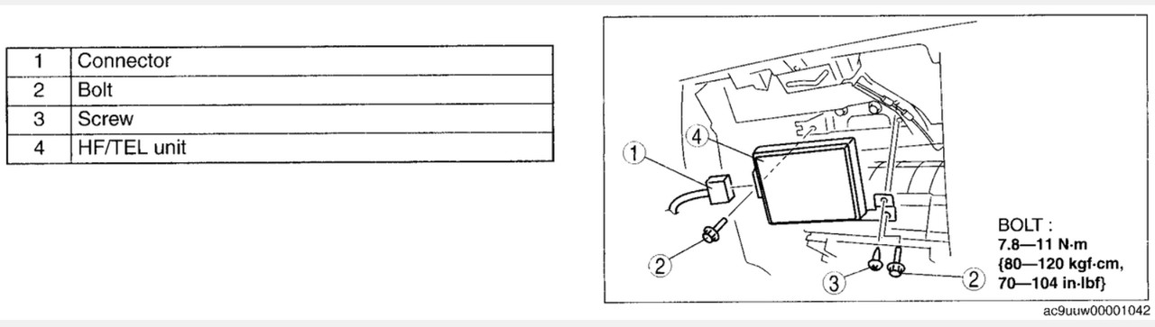

https://www.mazdaforum.com/forum/maz...c-drain-39452/
from the thread above - looks like another member mentioned that the cause of the parasitic drain was the Bluetooth module
my Bluetooth stops working 5+ yrs ago and my parasitic drain problem started just last year, but best to first fix known problem
will someone be able to help me locate the Bluetooth module
Old Aug 14, 2023 | 12:24 PM
Mazdaon's Avatar
Joined: Jun 2021
Posts: 162
Likes: 4
From: FL
Very common issue not exclusive to Mazda, Hands free telephone module is behind glove compartment.

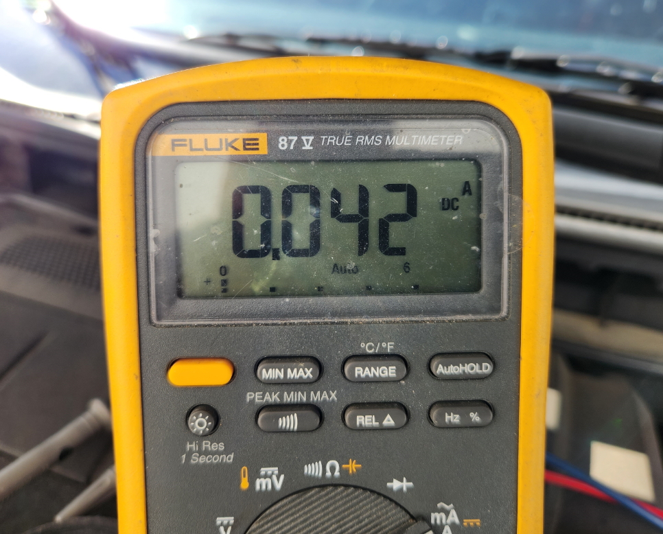

Update: fix the problem😎
- it's the Bluetooth module
- after i disconnect the cable attached to the module, turn off everything, locked all doors and wait 30mins
- my current went from ~300mA to 30 - 45mA
please remove video if not allowed - just a video of the current draw
- location of the Bluetooth module is on the right side behind the glove box compartment
