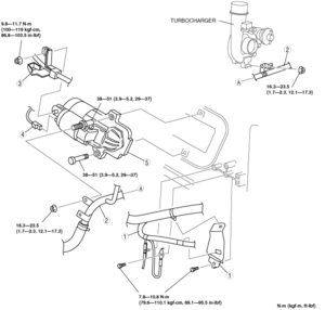

I've done that the heater pipe is in the way the bracket is on the pipe how too remove pipe
Old Jan 28, 2018 | 04:26 AM
Posts: 7,847
From the workshop manual.
Heater Pipe Removal Note
1. Remove the heater pipe with the water hoses still connected. Position the heater pipe so that it is out of the way.

. Crat, I am in Dothan. I just did a starter replacement on a 07 CX 7. The nut to loosen the heater pipe is behind that plastic air duct, just below the turbo. Once you loosen it you can get enough play to remove the heater pipe off of the stud on the starter.
