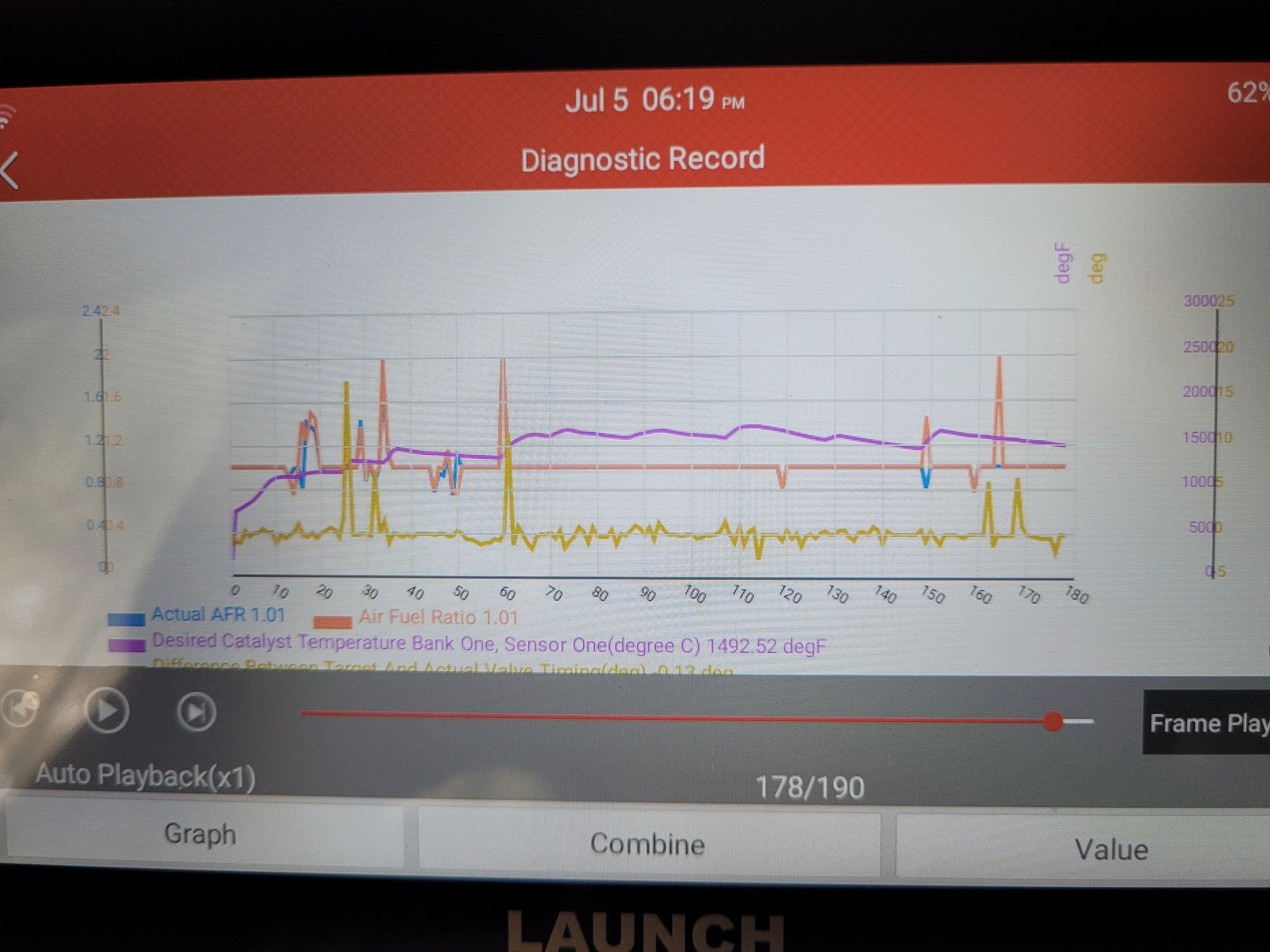

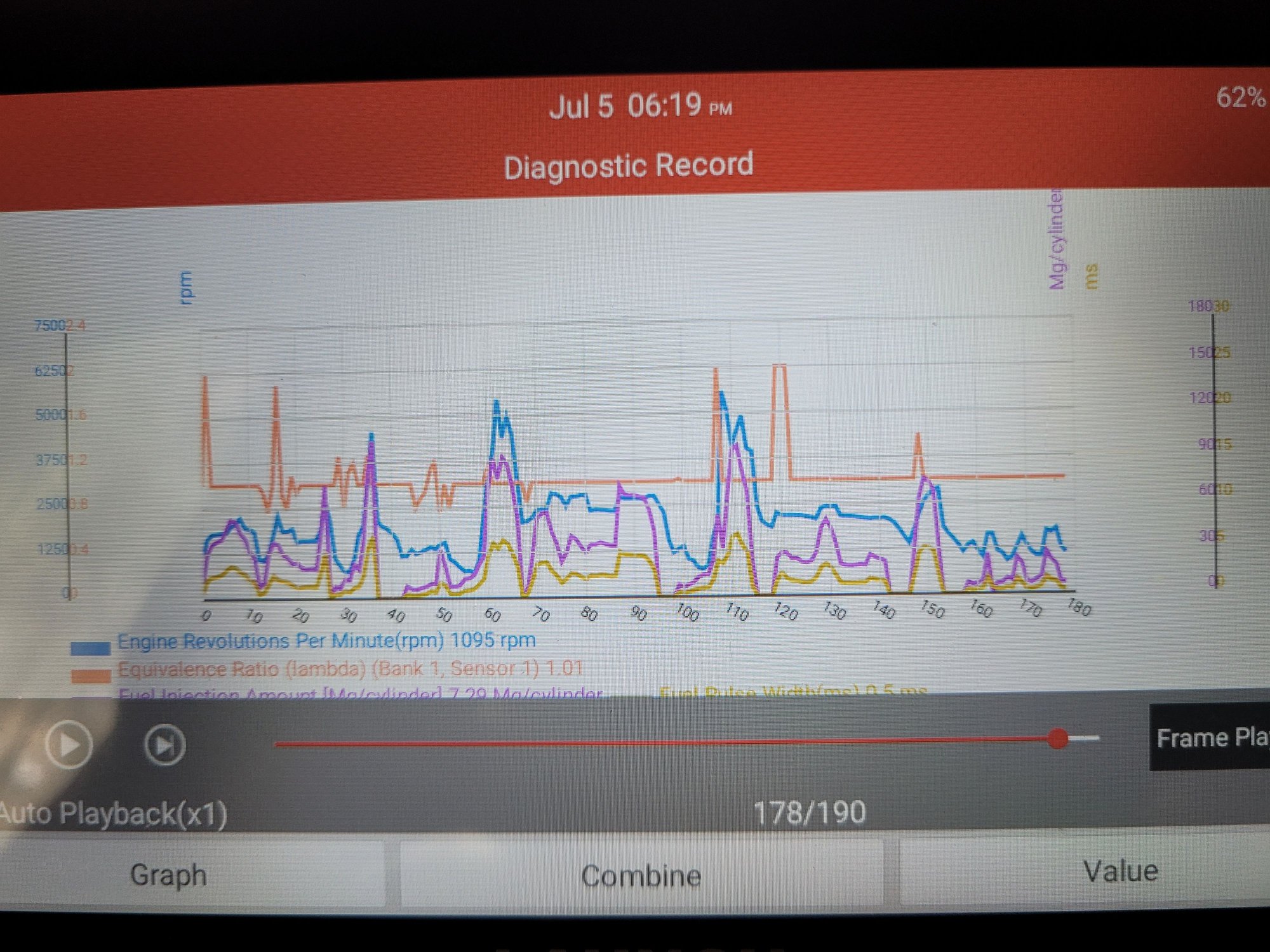

I have an 07 CX7 2.3 turbo. The spark plugs foul after 100 miles or less of hiway driving. I've attached pics of my scanners live data read out. Shouldn't these be mainly in closed loop for efficiency? The data is from warmup to hiway driving. Scratching my head on why its mostly in open loop...no codes at all. Slight hesitation in fast idle. Stalls and sputters after plugs are fouled obviously.
Scanner graphs have the legends on the bottom left hand side.
The etc as well as map, maf, determine whether the pcm goes into closed loop. All check out fine. No codes triggered whe it finally does go in goes into closed loop for a short time. Was on the hiway on cruise control just fine before slowing down not volunteeringly to a max of 40mph. Sputtering when trying to accelerate. Cleaned fouled plugs, runs fine until fouled again. Through all of that, no codes. Pcm thinks that's just fine. Heavily leaning toward bad pcm because of the above

No it's not too technical for me as I'm an ASE certified technician. Just not 1 response in 2 days so I assumed its too much i came here for ideas response, not take it to a mechanic....Maybe it's because it's a Mazda, idk. There's not much I left out. The plugs foul within 100 miles of driving. New plugs and coils. No lift or stft as it won't hit closed fuel trim. As you can see from the graphs I attached, the AFR are within range. In live data, that didn't show ect climbed with respect to temp which yells the pcm to go into closed loop. My pcm is fouling my plugs because it's not l going into closed loop. Map, maf, tps, ect, all in range where it should be. As you can see from my scan data, the pcm will briefly go into closed loop, where it should throw a code if there's a problem. But yet, no codes thrown when there's obviously a problem. 220 miles per I tank of gas and cleaning plugs is an issue. Any information anyone would like, ill get it.
I'll check the ecm link ur talking about. Would like to be thrown ideas for a solution. Thanks for the reply!
