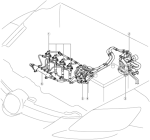

Just wondering the fuel filter location in the 2011 2.2L diesel?
I can't find it anywhere online.

Back LH corner of engine bay. Hiding behind the battery box.
Attached Thumbnails Fuel filter location in the 2011 2.2L diesel-cx7-fuel.png

I have a 2011 CX-7 2.2 and, rather stupidly, i have managed to run out of diesel. Took it for MOT after being off road for 6 months and should have added some before, but it's only a mile....
Have added a gallon and while it starts it won't take any load/idle without the engine dying. Assuming as first option air in fuel lines (it's been started and run monthly and drove the mile to garage ok).
Was hoping to prime the fuel system but can't find any way to do so. Found fuel filter (thanks to this thread) and assumed it would have a primer but even if it does it is so far hidden under bulk head it would be useless. Anybody know of an easy way to prime?
