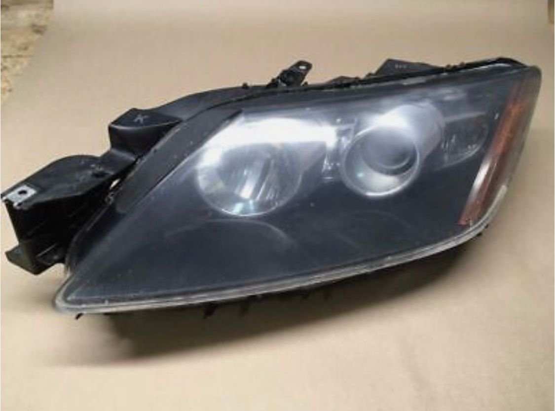

Hello everyone, need some help I’m trying to purchase a used headlight on eBay. On all auto parts store they have them listed 07-09 10-11, 12 as all fitting just those years. On eBay people have listing that say 2010,2011,2012. I even had someone selling 07-09 tell me it would fit 07-12 as long as it’s halogen which is what I need. it’s making my brain hurt not being being able to get a straight answer from anyone. I’ve emailed people selling new 2012 non oem and they say it only fits 2012 so I don’t get how others say 10,11,12 all fit even 07-09 will fit. I tried looking at photos and can’t tell which year it is they all look different some have more of a plastic thing under the front bottom area. I attached 2 photos one is 2010-11 other says 10,11,12 Any help would be appreciated. Thanks.
Listed as 2010-2011
Listed as 2010,11,12
Listed as 2010-2011.
Listed as 2010,11,12.
Old Oct 4, 2022 | 06:33 AM
Could be the facelift JM*ER10*100 vs JM*ER10*200
