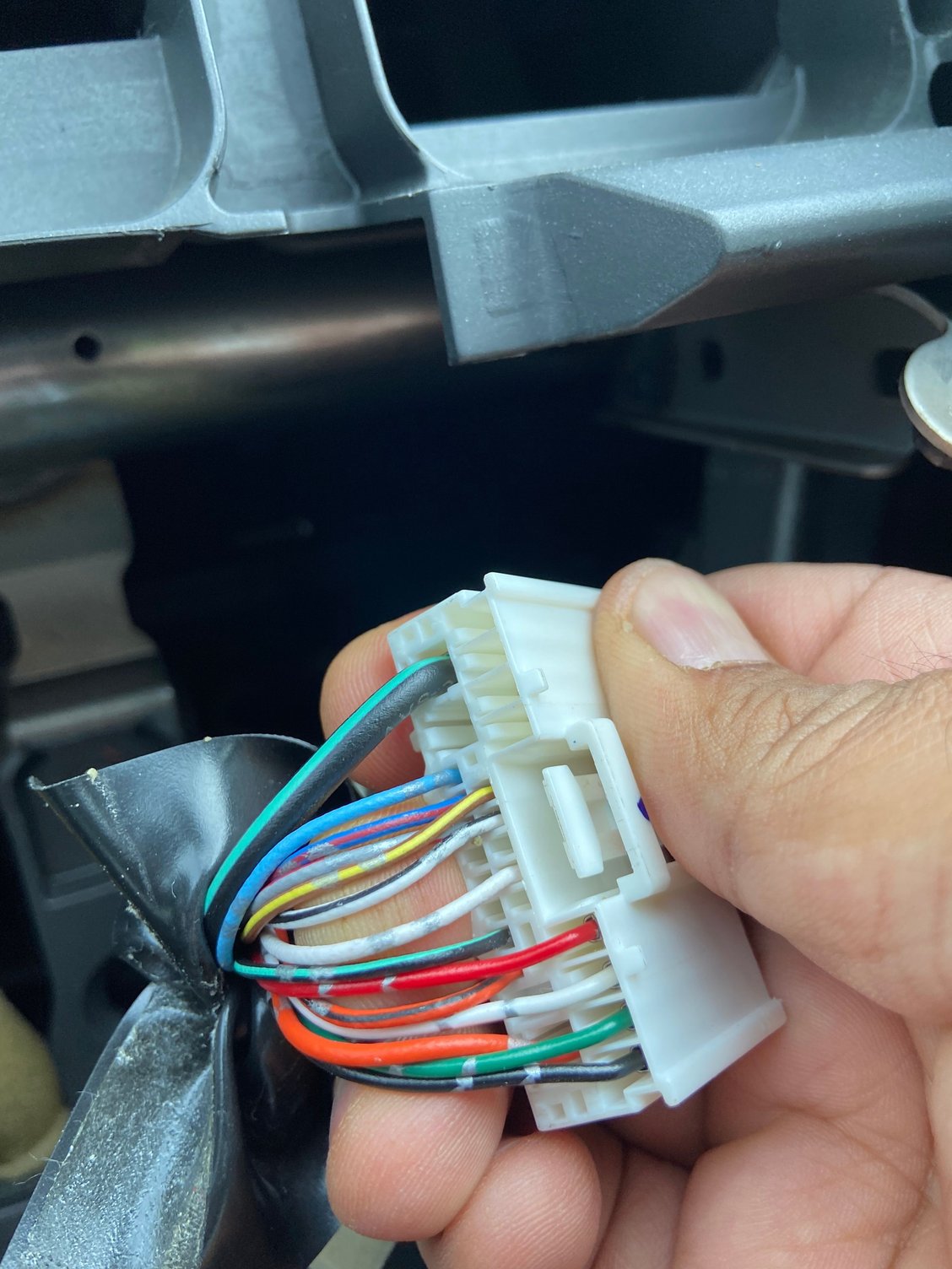

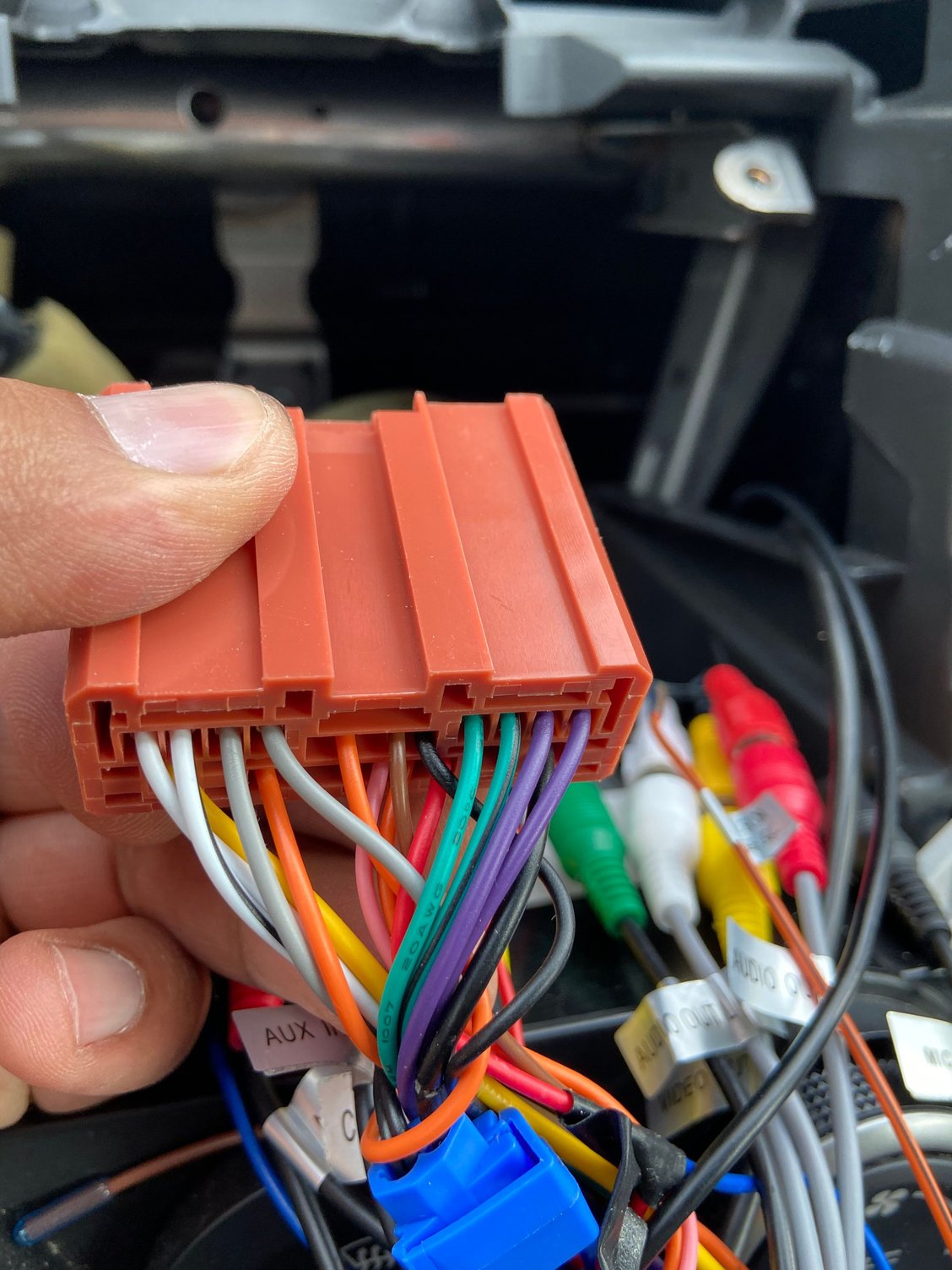

I have a 2010 cx7 with Bose system I’m trying to install a android player every thing is working only the sound is problem I don’t have any sound. Any one have any solution?
Old Aug 2, 2022 | 07:37 AM
Most likely you need to wire in a power feed or trigger wire to the amp.

I just bought a carplay kit for my mazda cx7 2007 luxury from Aliexpress, and I'm facing the same problem as this user above. Apparently it might be something related to the amplifier that comes with this specific model. I have tried everything that i could find online but no success. Even connecting the AMP cable into a power source didn't work. Anyone managed to solve this ??

CX-7_2007, Do you have the Bose system in your CX-7? ( BOSE logo on door speaker grills)
If you do, there is a specific aftermarket wiring loom for the Bose system.
https://aerpro.com/vehicles/mazda/mazda-cx7-2006-2009-er-series-1#-
https://aerpro.com/sites/default/fil...BVOA0o&src=api
