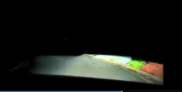

Angry Windshield shadow picture
Attached is how the shadow is with low beams. You can see that you have a very narrow field of vision--which I believe is a serious problem

Don't understand your use of the word "shadow". It would appear you're talking about the "cutoff" designed into the light which defines the pattern along the top edge of the beam. This is true with the standard halogen lights too and some people have a difficult time adjusting to it. Mazda has used this style light for years; my wife's '06 Miata has it. On my CX-5 Touring (regular halogen lights) I adjusted the lights up a bit (easy to do with adjuster mechanism on the back of the headlight bucket). If the dealer says yours are properly adjusted to factory specs, you may want to consider making a similar adjustment yourself. Just make sure you don't end up getting flashed by oncoming drivers, which would indicate that you've gone too far.

Yes you are correct. Shadow is the wrong description. It's like a curtain across the windshield that narrows your field of view. I cannot believe this is standard for halogen or any other type of lights, How are you supposed to see when using low beams ,going around corners, or going down hill. The lights cannot project a beam far enough --totally useless. Never had this problem on my Toyota's. I may have to sell if the dealer cannot rectify the problem--because the car is useless at night. VERY disappointed in Mazda

No need to sell. That "curtain" can be adjusted higher. If the Mazda dealer can't or won't adjust it a independent shop can. By adjust it I mean move it higher. New lights are designed to have a sharp cut off so they don't blind other drivers. Your lights look just like the lights on my 01 Audi and my 03 Mitsubishi
If you get them set to the correct height I think you will like them.

Yeah, I'm totally baffled by the shadow description. I know the cutoff on the HIDs is pretty sharp but I don't consider that a concern. I am, however, very impressed with the vision to the right of the vehicle. My first night trip I could clearly see the deer by the shoulder of the road.
There is a cutoff to the upper left of the beam to avoid blinding oncoming drivers. On a dark road, hitting the high beams has no effect on brightness - it simply moves the curtain allowing the beam to project into the upper left.
This setup is simply the best headlight performance I've driven behind - and I've yet to have anyone flash at me with the low beams on.

I also think your use of the word "narrow" is a bit confusing. Narrow to me is like a hallway - restricted left to right. If you mean the upper portion of the beam pattern is dark, I call that "shallow" meaning depth.
Have you ever had a car with HIDs? A sharp cutoff on the top of the beam is normal. If you feel yours is too low, you can have the dealer take a look at it but these HIDs are self-adjusting. Put a heavy load in the cargo area and the headlights adjust down to avoid blinding oncoming drivers.

Thanks for all the feedback. Perhaps my description is a bit wrong. What I am seeing as shown in the picture is a curtain that extends down from the top of the windshield leaving a very small window above the dashboard area to view through How anyone can drive safely with this condition is beyond me. No I have not had previous vehicles with this type of lights--- but lights illumination should project far enough so you don't have to nearly stop going around corners or downhill. Thanks
