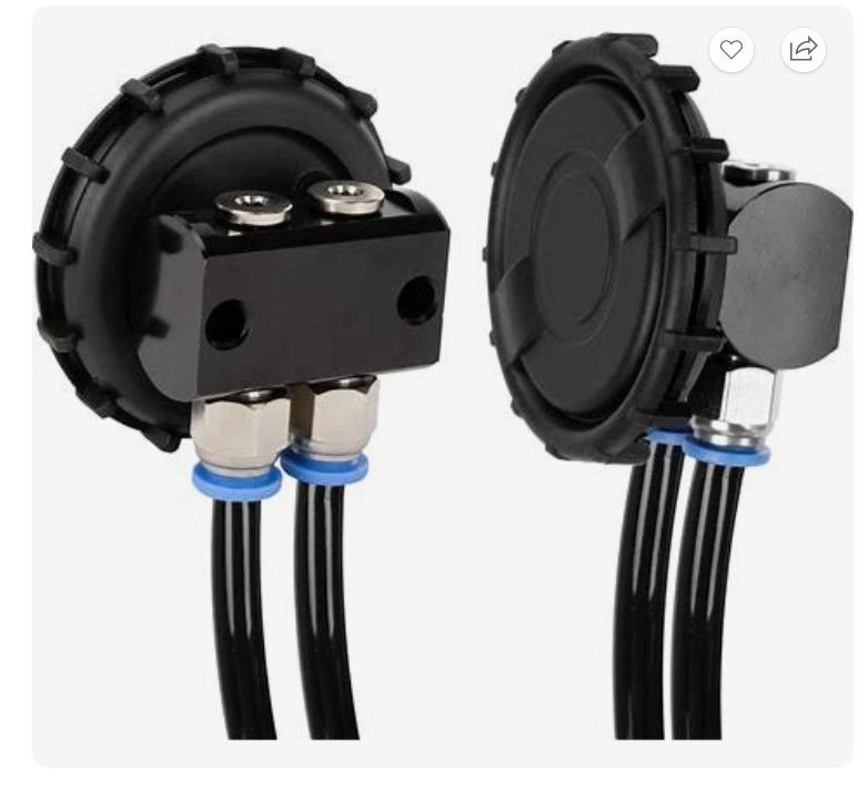

Callisto, I will have to disagree with you about clogged vent valves ,especially if one lives and drives in areas where ice and snow are common. These spring loaded valves will rust shut over the years. Then when one drives esp in hot weather the spring isn't strong enough to force open the vent and depressurize the diff., leading to leaky seals. and worse.Doesn't matter if it's a Mazda, Toyota Subie, Honda, They are all the same. And a real MF if one as to change one out. I check mine every oil change and spray some CRC screwloose to keep it working properly. Just my 2 cents
Old Apr 13, 2026 | 12:54 PM
  #20
Posts: 10,726
Likes: 236
Ok well you are the exception to what most DIY and service shops know. Pop over to a 4x4 forum and post your information see how well its accepted.
I do applaud you attempt of preventive maintenance, maybe try considering swapping the CRC for GIBBS or Marvel Mystery lubricating oil. I use and stock all 3 and the last 2 seem to work better for your type of purpose then CRC.
Here this looks like a great product for you to spend your money on your theory
LOL
Differential Vents - In Stock Filter Options - Vendor In Stock Filter Options - Free Shipping on Orders Over $125 at Summit Racing
Or
Suitable Models: Differential breather kit fit for 4×4 4WD accessories replacement 170112 differential breather Safety and Durability: Differential axle breather in the case of high temperature or long time driving, the kit can increase the ventilation holes, heat sinks and other structures to effectively ventilate and dissipate heat, to prevent high temperatures or water caused by oil dilution or damage to parts, to prolong the usability of the transmission system Water Breathing Apparatus: Differential ventilation kit high-flow air filter and manifold to vent up to four driveline components high enough to be centered.(To avoid water pooling while traversing,like a water breather) Waterproof Construction: Differential axle breather kits prevent water from contaminating the oil and damaging driveline components by providing a backpressure-free breather system Package: 1 X manifold;1 X air filter assembly;4 X push fitting locks;3 X plugs;1 X tubing;2 X screws;1 X teflon tape,cable ties (4ports to connect up to 4 breather lines 7 air filter port) Fitment Compatible with 4×4 4WD Accessories Replacement170112 differential breather kit Differential axle breather safety and durability,water and heat resistant, easy and quick to install Feature 1.100% Brand new aftermarket item. 2.Differential breather kit safety and durability,water and heat resistant. 3.Waterproof, durability and wear-resistant. 4.Differential axle breather kits waterproof construction. 5Easy and quick to install. Notes 1.We strongly suggest comparing the posted picture to your faulty/old unit! Please kindly check your vehicle’s model and confirm this item is suitable for it before ordering. 2.The product does not contain installation instructions. If you have any questions about that, we kindly recommend you go to the nearby mechanic to ask for professional instructions. 3.Installation: Easy to install, assemble and remove with great convenience, direct replacement. Highly recommended installation by professional. 4.Color Difference: Due to the light and resolutions setting difference, the item’s color may be slightly different from the pictures. 5.Please allow slight dimension difference due to different manual measurement.
