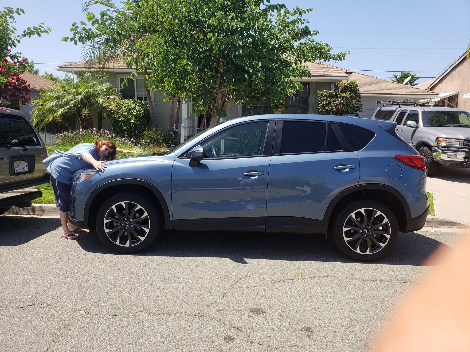

Thank you! She has a 2016 GT which does have a sunroof, does the drain tube run towards the back end, like the spare tire well area?
Yeah, normally it does not rain here. That's why we lose our minds and everyone just starts playing bumper cars on the freeways when it does. We had a storm a few weeks ago that gave us of a third of our annual average in about 6 days.

Nice color.
