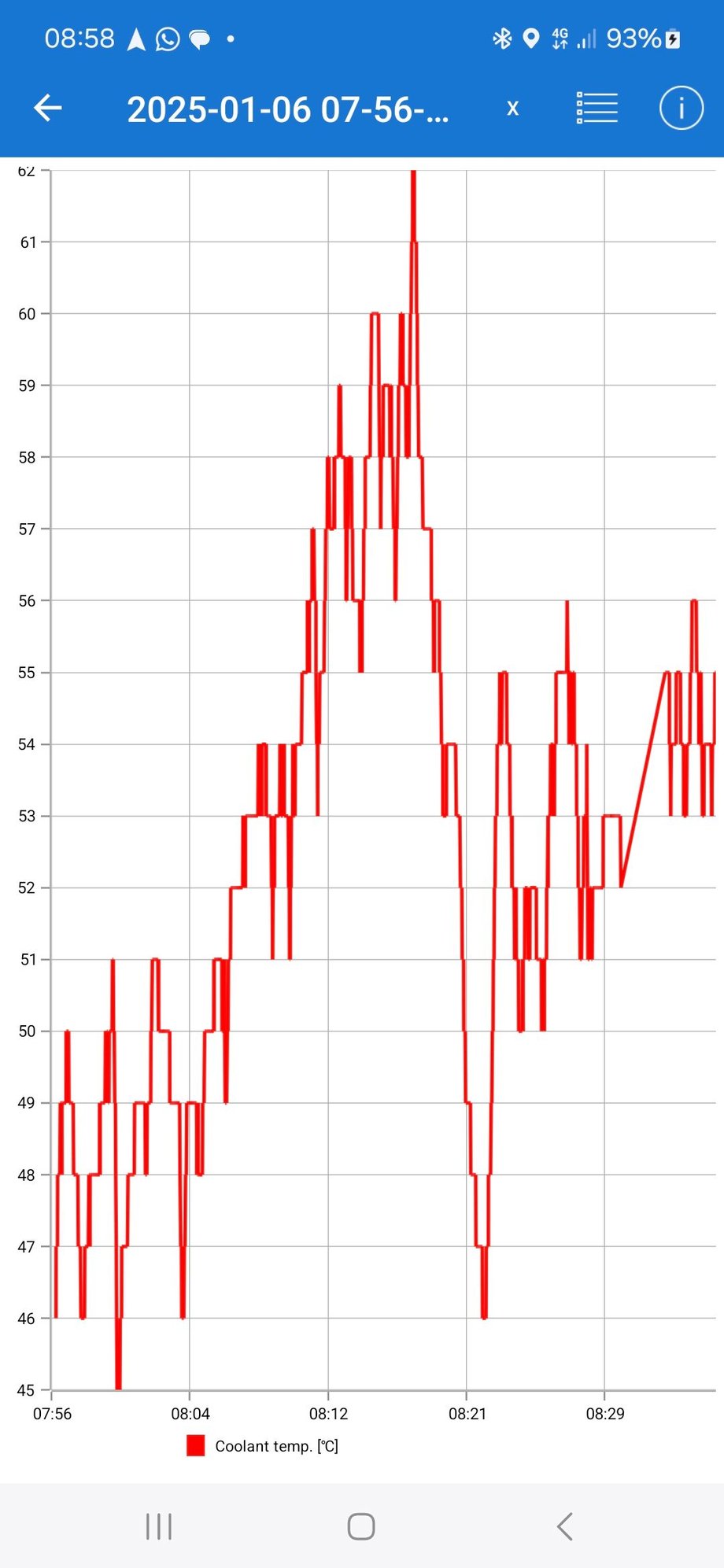

I have one of those Bluetooth odb no live error codes.
I ran temp live data over a morning drive (see below)
I went to Mazda tech this morning, he said it's normal in the cold. Showed him the graph and he just didn't seem to be interested.

Yeh literally they did that, lol.. just looked the other way and didn't care, and well it makes sense they can't trust that data.
The only data they trust is from their own diagnostics machine which is understandable.

And the chart. That so could have been made in MS Paint :-p
