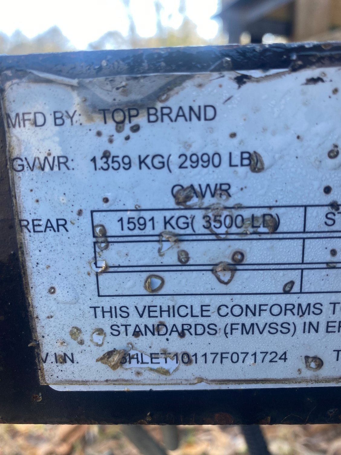

I have a 2020 Mazda CX5. I plan on adding a Class 3 trailer hitch. I’m concerned about towing this trailer:
Is that too much weight for the CX5?

I'm looking at the trailer towing-load table in the owner's manual.
I'm not sure what value I need to focus on.
TTW, GCWR, GAWR, GVWR.
I'm thinking the trailer may be too much for the vehicle.....

You don't say what type of trailer it is cargo/utility/boat/camper/livestock etc.
GVWR (1359KG / 3500lbs) is the maximum safe gross vehicle weight of your trailer plus what it is carrying
REAR (1591KG / 3500lbs) is gross axle weight your trailer can hold
It is a Top Brand according to the tag and if you know the model you can look up its weight online.
As Alex said if you don't know you'll need to get it weighed.
Once you have that weight you will need to add it to your cargo weight to get the total weight being towed.
Total weight up to 1500lbs the NA engine
Total weight over 1500lbs up to 3500lbs need the turbo/diesel engine and to be safe you may want trailer brakes as well.
