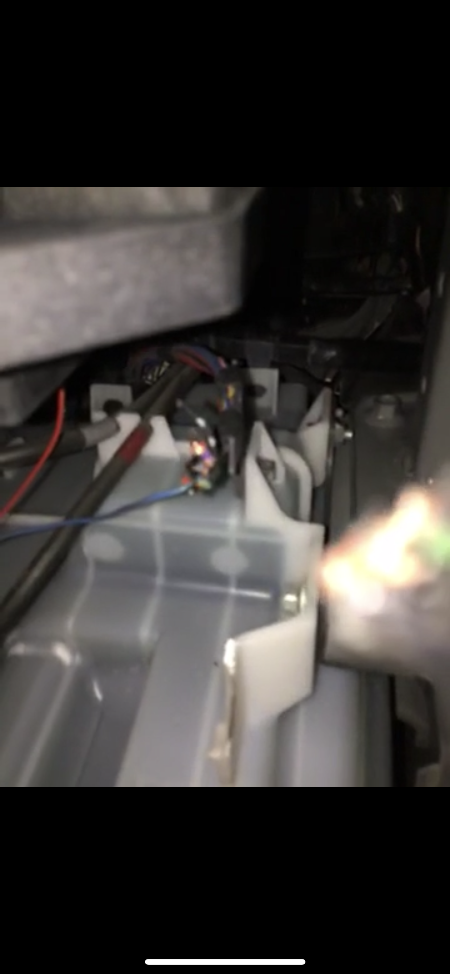

Rodents chewed through the wiring to the fog, lights and windshield washer fluid. The dealership is stating the entire wire harness needs to be replaced which is over $5,000. Is this is necessary?
I feel like it should be easy to replace the wires for the windshield fluid reservoir and fog lights alone.

Or use a mobile electrician who can do a professional harness repair, and verify it's integrity via their test equipment.

Thanks, I did not think of a mobile electrician. I will look into that.

Dealership normally do not repair sections of bad wiring due to rodent damage because of liability and safety reasons.
I would suggest NOT to use a Mobil service and find a specialized Auto Electric shop. If there are none listed then contact you local Police and Highway patrol they may be good enough to tell you who did thier vechles eletrical servicing and instalations of all the eltronic they use.

Thank you and much appreciated. I found an auto electric shop in my area and will check them out.

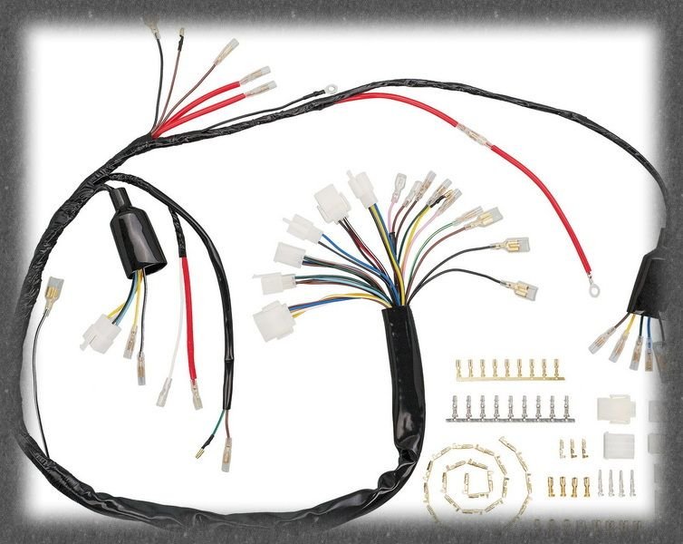

OH you will like this... I just purchased a semi complete wire harness kit for my Yamaha XT500. Estimated install time about 4 hours?

4 hours for wiring a motorcycle...hahahaha
Then 3 days of sweating, swearing, cut knuckles and who knows how many 6-packs to hide all the wires.
Unless it's an old English Triumph, Norton or BSA with those fine Lucas electrics and then it's an eternity....
