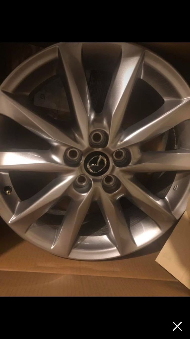

I really need some advise if this rim will work with my 2018 CX5 GT
i want to get this for winter tire was a pretty good price
but the seller said it’s from a Mazda 3
thanks everyone

Yup, they'll work.

So even my wheel is 19” they will be ok
sorry I might asking really dumb questions

I am not sure what you're asking; are you somehow suggesting to mix 18" and 19" wheels? If so, very bad idea.

No it’s actually for a set of winter tire
its has 18J7 this also will work?
cuz these are from a Mazda 3

As a set, those wheels will work assuming you wrap those wheels in the proper size tires.

I would suggest to check the wheel and tire sizes with tirerack.com. It looks like you would need a 18x8 or 18x8.5 wheel and most likely 225/60/R18 or 235/60/R18 tires. Also double check the offset specs.

I checked; the wheel size is a dead ringer for what they recommend for 18" wheels for the CX-5.
sounds good
then what sz winter tried I should get

If you go to TireRack.com and query up winter tires for your CX-5 and specify the 18" size, they'll give you a bunch of options for winter rubber.
