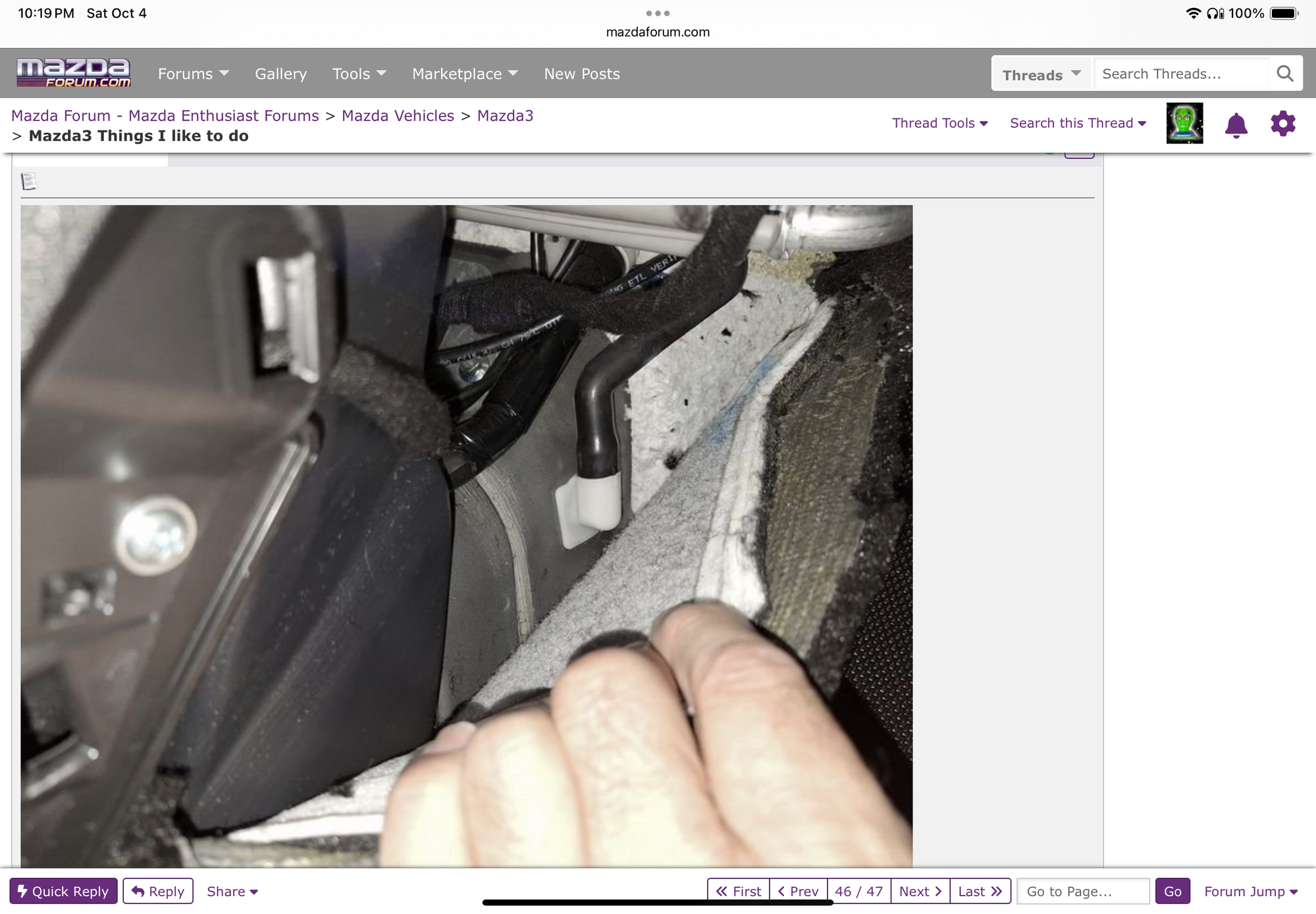

I would think that a 2024 model would have climate control and if like me on all the time and the windows up. That pic you just posted is where I think the ploblem is. Either the hose has come off/never been fitted correctly or has a leak somewhere.
