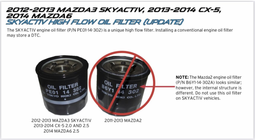

The current Mazda recommendations for oil filters are:
1WPE-14-302 For non turbo engine. Made in Mexico.
1WPY-14-302 For Turbo engines. Made in Thailand.
These are Asian Fram 6607 size filters.
The Fram 7317 size filter is the oversize filter.
Fram XG7317 (Gold) is the best commonly available.
