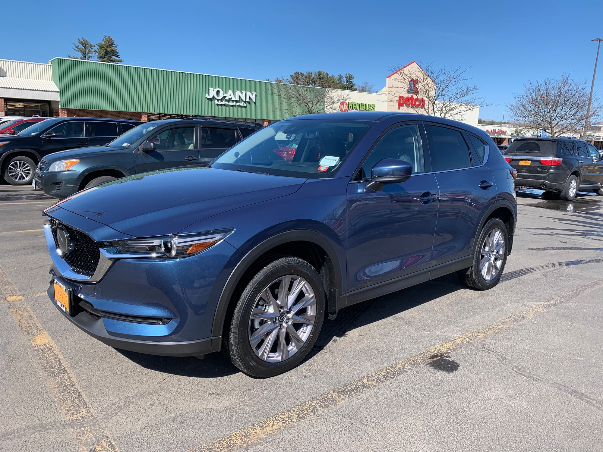

New to this forum. My wife recently purchased a 2019 CX-5 Grand Touring Reserve and was recently told by shop that our spare tire/wheel that came with the vehicle doesn't fit the hub lugs for our 19" factory wheels. Can anyone help explain this? I would go out to check vehicle myself but car is in shop at the moment. Pics of the vehicle for reference.
