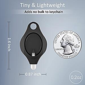

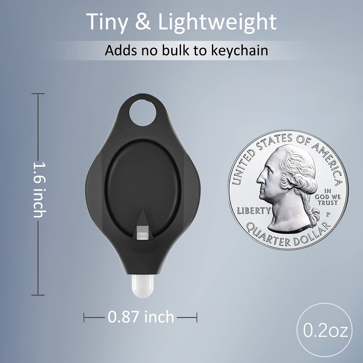

It's very easy to change most of the interior bulbs to LED. Use the Sylvania Bulb Finder https://www.sylvania-automotive.com/bulb-finder.html. All you need is a flat screwdriver to remove the plastic covers.
I also attached a small, rear facing CR battery keychain LED using VHB tape between the two LED spot lights up front, so I can leave a light on without using the car battery. Lights up the entire interior.
