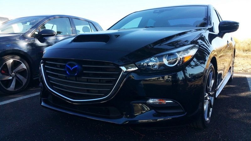

This was the first fiberglass hood that was bonded to my factory Mazda hood in Feb 2020. Later I went with a larger fiberglass hood scoop.
The CAI I never published pictures because I did not want anyone to copy its design.
