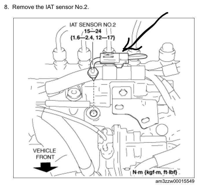

OK so I had some of the engine apart to do carbon cleaning of the intake manifold. It involves taking the Intake accessories, EGR and accessories off of the engine as well as the manifold.
Turns out the P0098 IAT Sensor #2 High Input was correct diagnosis of the root cause. I had it off during the cleaning, plugged it back in during re-assembly, then ‘half’ unplugged it again (not completely disconnected but not connected) to re-route the wiring correctly, and then forgot to re-seat the connector completely back in, again.
Picture attached of the guilty sensor. I’m surprised such a small thing can cause such huge car problems.
