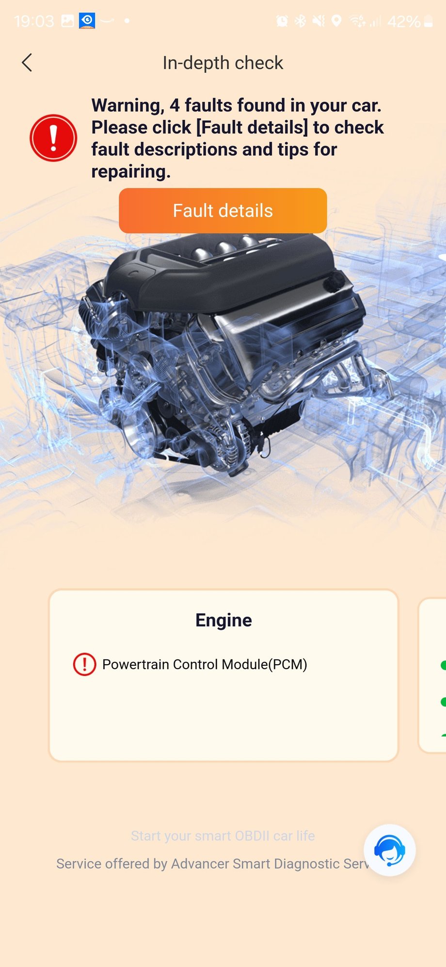

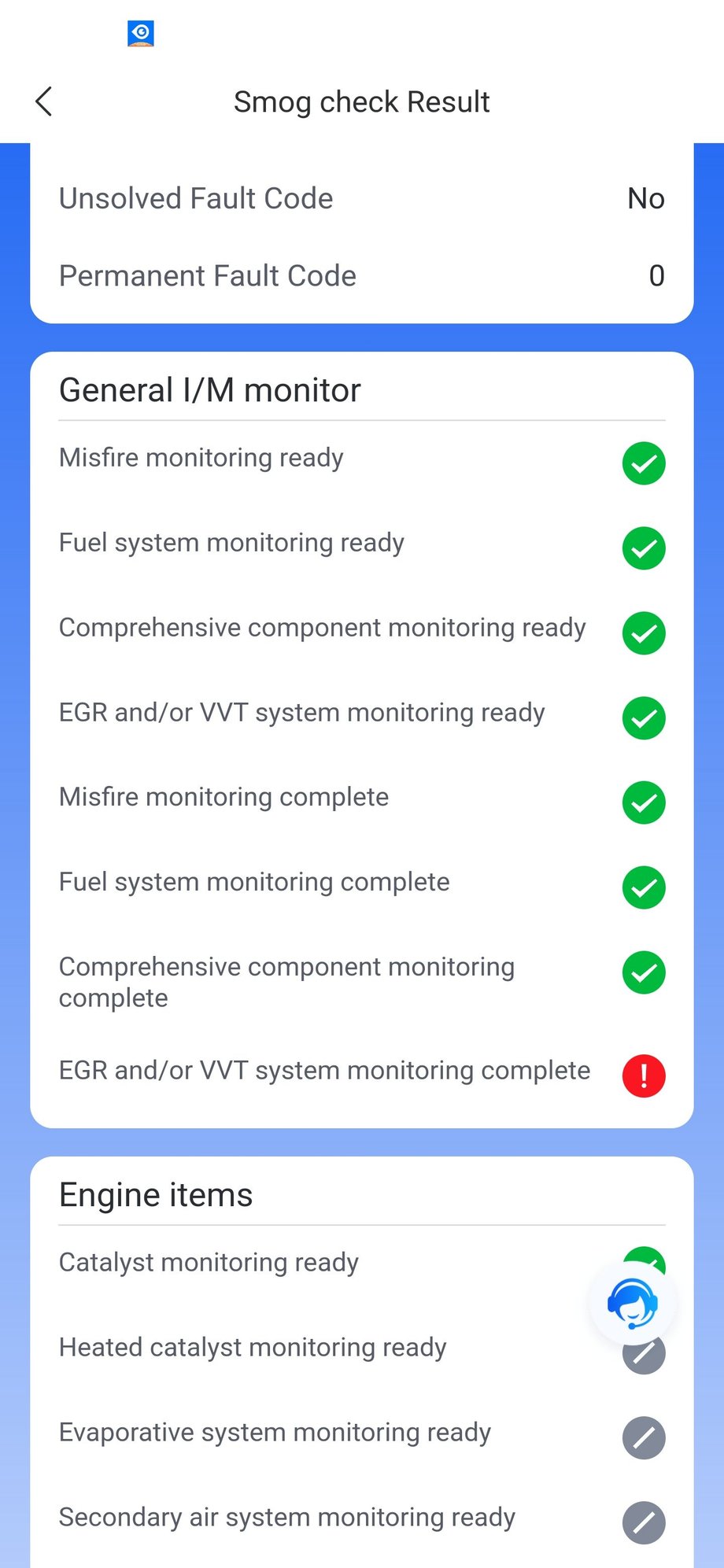

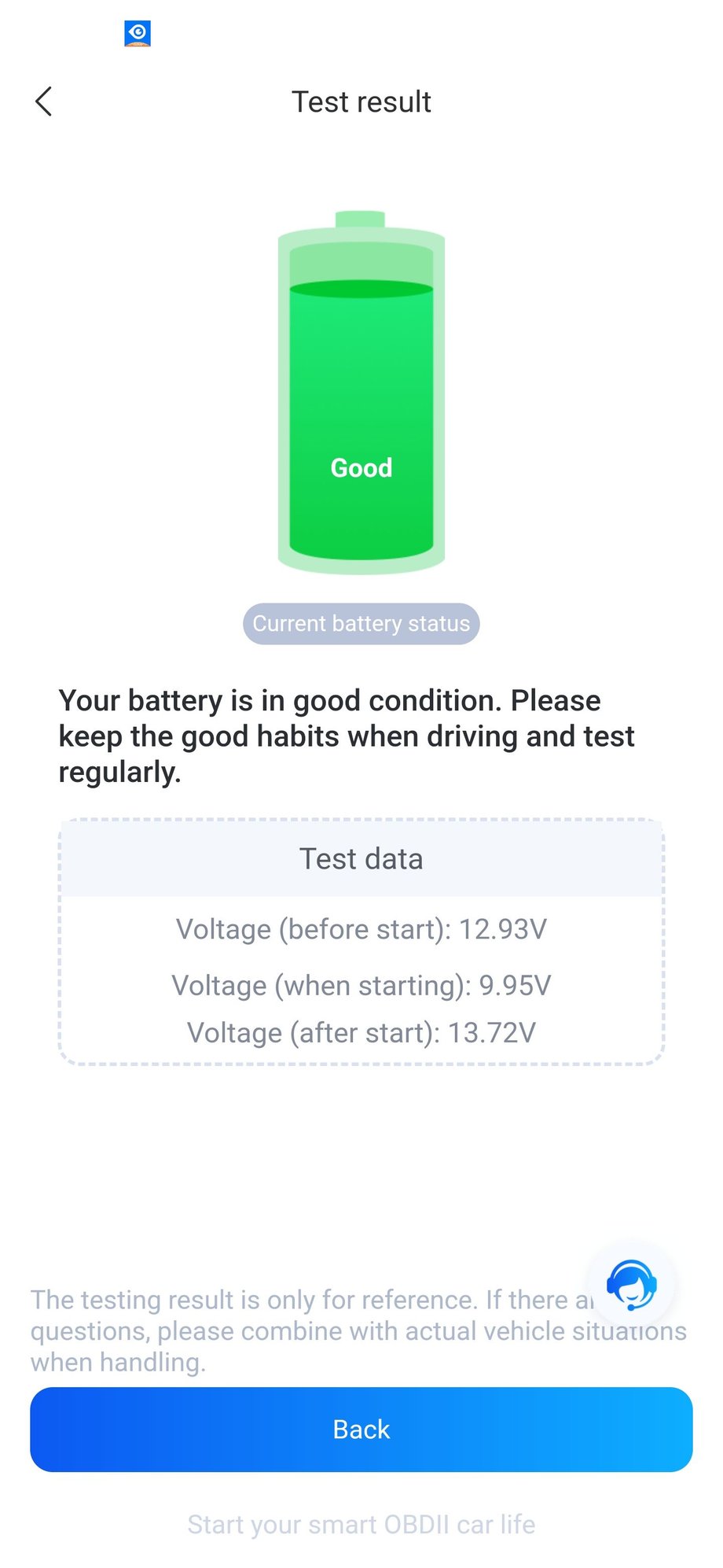

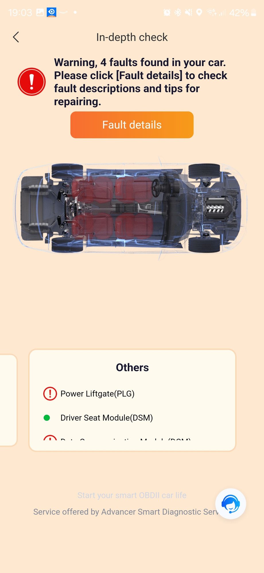

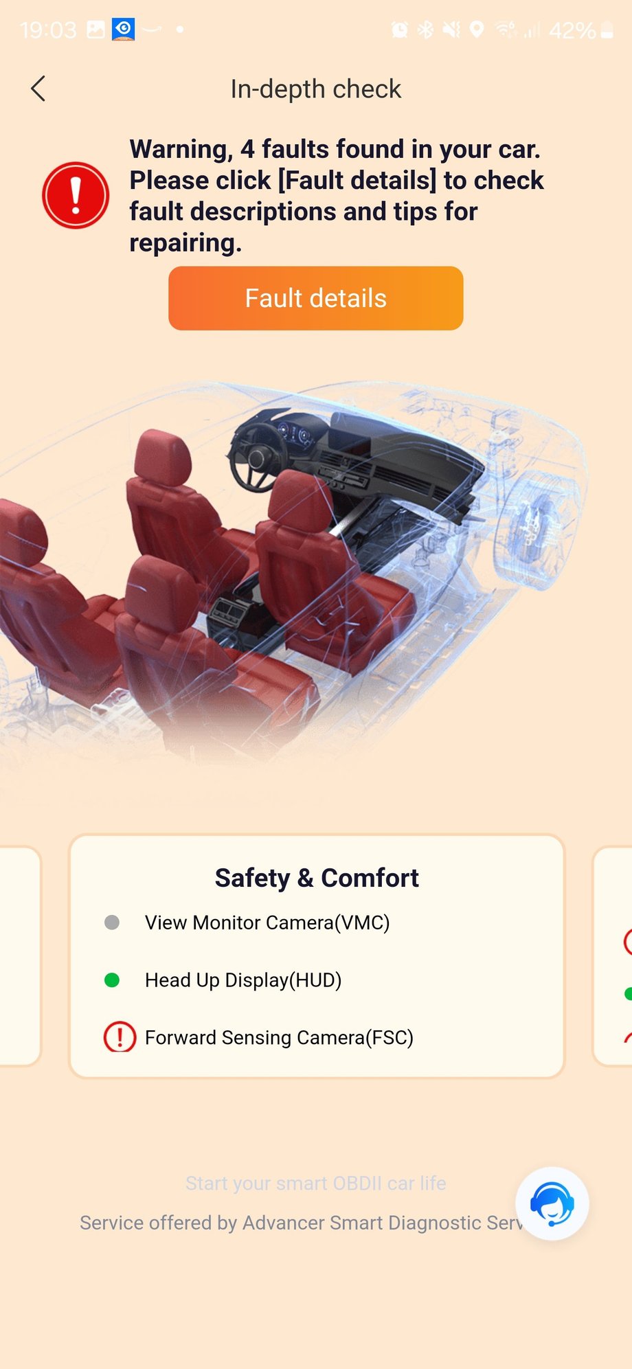

Old Aug 16, 2024 | 01:08 PM
Loveamazda's Avatar
Joined: Aug 2024
Posts: 23
From: Midlands
Have just plugged the OBD in and got the following results.
again I've not much idea what I'm doing so any help would be appreciated
