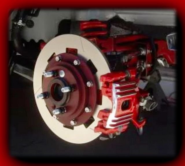

Actually you knowing the material composition and how the base disc was manufactured has everything important to do with a conversation pertaining to a disc/rotor not performing as thought properly unless you can empirically explain how yours faulted. Its how they are used.
As for BMW its because it sells vehicles. Some of us that are "ENGINERRS" in the Automotive industry and especially those that design performance parts know that. LOL
Maybe better have a look at f current design of Formula 1 and NASCAR? Those that are using drilled and or slotted rotors are generally because of their contingency and not for better braking. And the slots are used for a different purpose then once thought. You can also look into several testing of rotors using thermal imagery and temperature measuring that actually show that overall, more surface area is better for braking and the old school testing and theories their results decades ago of why use slots or rotors have been replaced basically due to better quality raw material and manufacturing processes.
I purchase raw disc and machine them as per what my customers want or for a specific use. The material on some I require a certification sheet as to it material and at times a copy of the x-ray. I have personally had BMW rotors like you mentioned x-ray and found dark area's that indicate manufacturing quality. Most predominately with their drill and or slotted rotors. I have personally talked to a BMW drivetrain engineer about this and he said that it fits the qualification for safety on a production line BMW that were NEVER intended for performance usage. Why you ask would I happen to choose BMW as an example.... not to debate on something you have little information about, but it just so happens one of the Platforms I offer a BBK (Big Brake Kit) both front and rear (even an ECU program adjustment and or electric or mechanical brake bias adjuster) a BMW manufactured model in the early 20's. lol
The 3 grooves in my machined by me disc are to specifically help reduce or prevent brake pad material caking because this set up in the picture uses metallic performance racing pads.
Pictured My Rear BMW model BBK. Completely engineered and designed and built/assembled by me.
To further give my experience about brake parts specifically pads and disc/rotors on my personal MAZDA thread I have a front and rear set of drilled and slotted rotors that I machined specifically for the LOOKS not theorized outdated old school function of the drilled or slotted.
