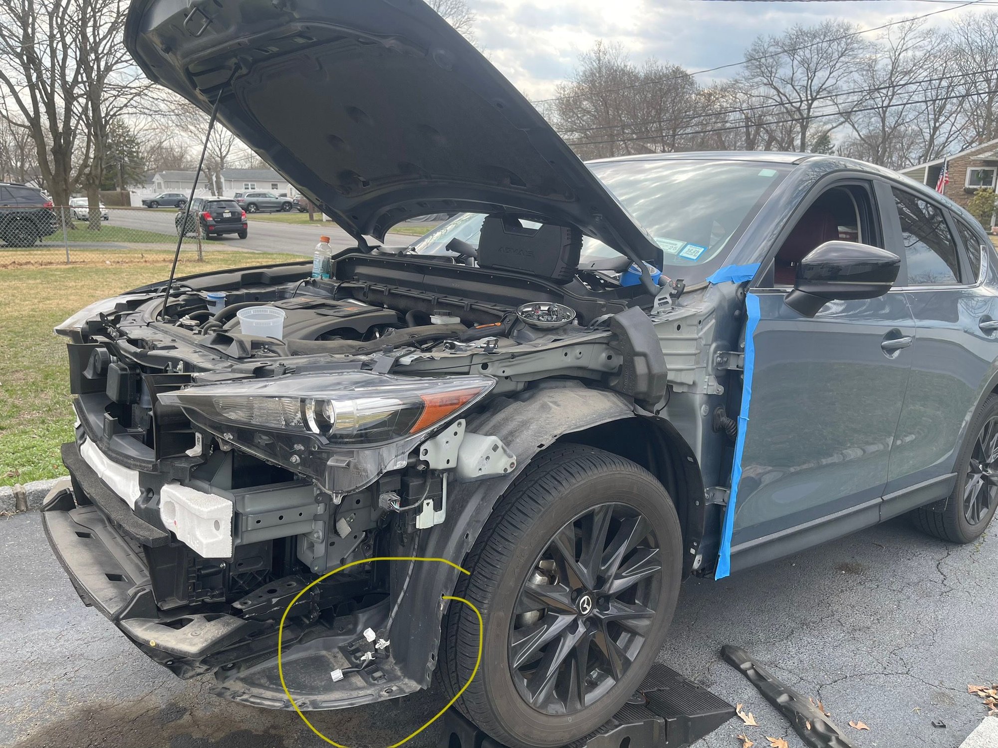

So I had the pleasure of having to replace a fender on my 21 CE after someone left a nice dent in it in parking lot and split. Nice people, right? Anyway, in the disassembly process while removing the front fascia I noticed there are 4 plugs, 2 on each side, that don’t go to anything. They just plug into the cover where the fog lights would be. That leaves me to believe these cars are max-wired and I should be able to add fog lights with minimal work. Has anyone done this?

Generally speaking Yes.
There should be complete kits available on the internet either *aftermarket ( *I personally have not looked for your specific Mazda )or you can go to a sight like Real Mazda OEM and buy OEM.
Perfect time to do that while you are this point in the body replacement parts.

That’s what I thought. Any idea where the switch goes so I look to see if a connector is there as well?

If you look in your owners manual it should show where the switch would be located if you had it as a feature originally.
The best thing to do if you want to know in advance how to install it is to pay a one day use with ALLData. You could also download a complete service guide as well.

UPDATE: in my YouTube feed over the weekend was a video of how to install fog lights in a CX5 (funny because when I searched, it didn’t show up for my generation). Anyway, I was right, it’s all plug and play. The hardest part is replacing the multi switch in the steering column and that’s super easy too.
