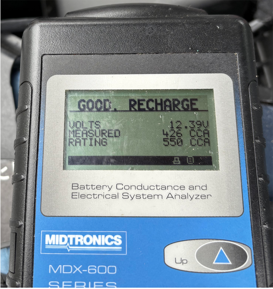

Pleased consider the following as a thread-starter, just to get a discussion going!
One of the things I love about this forum is its frequent reminders from experts about what we CX-5 owners ought to be checking routinely and also by mileage and "occasionally".
I took note of this particular thread and several others of late because they note that several members with 2021 model CX-5s have had the 12V battery "suddenly" die. Even though I've haven't yet had any battery issues, my CX-5 is also a 2021 model that's just over four years old, I so got out my trusty Midtronics 6000 series
Battery & Conductance and Electrical System Analyzer and tested my OEM battery. Here's what the screen read with the engine off:
Voltage: 12.39 V
Measured: 426 CCA (cold cranking amps)
Rating: 550 CC (cold cranking amps)
So when I took the reading the battery was down by about 124 CCAs below its rated 550 CCAs or (124/550) 23 percent. That means, nominally at least, that it still has (550 minus 124 CCA) about 426 CCAs

First you did not start a thread!
But perpetuated a fire with more fuel
Your reader is really indicating to charge and retest. Even if it is not showing on the test result page/screen
The minimum testing voltage needs to be rested 12.50 or more
Asking the internet question will always yield the answer you want that supports your belief system as thing in your world should be. If it were that easy why have a doctor ,dentist or someone paying tens of thousands of dollars to keep a current Automotive cortication updated with the most resent and best service information available for the time?
Charge and retest!
The results for CCA should be at or above the batteries manufacture rating.
Your starting voltage measure exactly at the engine rotating should not drop more then1.5 volts
You arrested voltage should be min 1`2.50 volts and after 12 hours should not have dropped more then .75 volts. Less and the battery in declining service or you have an extremely high system or parts draw that should be looked if that is normal. To rule out battery disconnect the negative lead when tested voltage stabilized is min 12.50 and then check voltage after 12 hours.
Also DIY should occasionally test the accuracy of their testing equipment with a known accurate professional grade equipment in this case battery load tester. You would surprise how many are inaccurate.

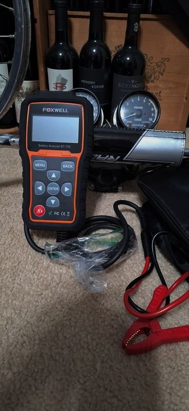

This is the one I have beeen using for abt 10 years now. Very accurate but as I said you need to make sure you have a clean connection to the battery or it will display bad readings. These units test battery, starter and alternator but there is a minor problem with mine in that it has an issue with smart alternators but still does the job. Hopefully the newer ones have software that overcomes the issue.
The old battery load tester is without a doubt the best method but having seen quiet a few open top batteries explode from incorrect use (the ten second timing) find it a tad safer to use this one.
Ten years... time for a new one. If you check it with a new one you may find it is no longer giving good information/results. Mine was about that old and it started showing new batteries as charge and re-test or batteries I know failing as good.
As for exploding batteries that has happened to me 3 times in my life I learned from those what not to do !
The old-style battery testers from about the 1990's and older do not do well (accuracy) with some of the AGM battery testing.
I see we have the same thoughts about a battery land charging system tester ?
My old one now discarded and my new one. lol
OLD:
MY NEW ONE
