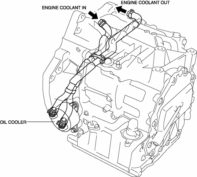

I note that the regular 2.5 Liter Skyactive Engine does NOT appear to have an oil cooler behind the filter. I imagine that the 2.5T does have the engine oil cooler. I do question the effectiveness of a cooler that uses circulating engine coolant to cool the engine oil. Since the circulating coolant is at 210 degrees (at least) at normal operating temperatures, pleas explain the physics (Dear Callisto) by which 210 degree engine coolant in a tiny cooler apparatus, cools engine oil at operating temperature (whatever that is)? What is the temp difference between the engine oil and the engine coolant (at each fluid's respective op temp that would result in significant cooling. In addition, same comment for Trans Cooler which presumably is resident for both NA and Turbo 2.5T (since it has to do with the Tranny fluid, not the engine oil). How does that meaningfully cool trans fluid using 210 degree engine coolant?

Thank you Dennis. Appreciate it. I was still wondering about why Mazda engineered an oil cooler that uses 210 degree (or more) engine coolant circulating through it to cool the engine oil. I don't see how that effectively cools the oil. They are at the same temperature! Or close to it. Best, Reuben

From my understanding the radiator itself has no connection to the oil cooler. The oil cooler is a tiny radiator labyrinth through which the engine oil runs - it is air cooled (no coolant). I know that is how my air cooled scooters worked anyway. Here is a video of one like I described being installed on a Miata:

The oil cooler on the turbo engines sits in front of the radiator, more or less. A small
radiator for the oil. Oil only flows through there. If I'm not mistaken, there is a thermostat
for the cooler. There is none on the NA engines.

There you go - so it is completely separate from the radiator, no coolant involved in the process.

Here is what I seen in the Repair and Service Manual for the Air Cooler (Turbo) and for the Trans Cooler (all engines). So it appears to me that the engine coolant is used to cool the oil or trans fluid, as applicable. So, I am still somewhat puzzled as to why they would use 210+ degree circulating engine coolant to cool the oil or trans fluid. And, as you see, this is not happening in the radiator. This is happening in their little tiny Dunkin Donuts cooler device.
Pls let me know if I am off-base. Thank you both. Reuben
