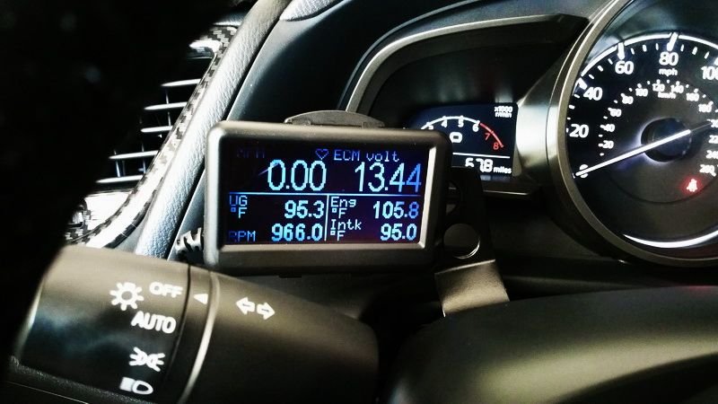

Ya... good response DesertRatR! Those numbers are almost [size=13px]identical[/size] to my MAZDA.
I did this morning to post up!ECU Voltage reading directly after stating the MAZDA's engine first time today. Last run period was Friday @ 4:30p.m.
Then the second picture is a few minutes of driving , notice voltage with AC and fan motor at mid speed.

Originally Posted by DesertRatR
BTW, what instrument are you using?
Not sure what you are referring to?
If it is the picture then that is an ULTRA Gauge.
The voltage registered is exactly what the ECU registers from the battery. So if you have a good quality Digital volt/ohm meter your readings should be the same directly at the battery and what the ECU input voltage should be. This is not the same thing as registering the voltage at a fuse. The ECU gets the power directly from the battery in order to control various ignition off features and monitors.
I have several of theses one in every vehicle of mine and a couple NIB. IMHO even though they are not colorful as using a cell phone and app they are much easier to use anytime and not worry about the downfalls of cell phone apps needs WiFi or Bluetooth.
Ultra Gauge
UltraGauge OBDII Scan tool & Information Center
Voltage at battery terminals depends upon the state of charge. A fully charged battery should have lower voltage when running, and should continue to drop from when first started until a steady level is achieved.
Yes it did drop under the load demand but if you read I said directly after starting and not during the starter cycling as you registered and reported you information. Which again I say was really good! LOL That voltage drop info is about the same as mine for the voltage demand during the start up cycle and starter voltage demand. And because we are cutting edges of information you can not measure battery voltage when a generator is active and regulated by the ECU , only the system voltage regulated by the ECU. Don't worry even before ECU 's on cars many even season mechanics often miss interpreted that reading.
