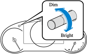

When the lights are turned on with the ignition switched ON, the brightness of the dashboard illumination is dimmed. However, when the light sensor detects that the surrounding area is bright such as when the lights are turned on in the daytime, the dashboard illumination does not dim.When the ignition is switched ON in the early evening or at dusk, the dashboard illumination is dimmed for several seconds until the light sensor detects the brightness of the surrounding area, however, the dimming may cancel after the brightness is detected.
When the lights are turned on, the lights-on indicator light in the instrument cluster turns on.
The brightness of the instrument cluster and dashboard illuminations can be adjusted by rotating the ****.
  • The brightness decreases by rotating the **** to the left. A beep sound will be heard when the **** has been rotated to the maximum dim position.
  • The brightness increases by rotating the **** to the right.
Dash display half black-05020807-glece01-001.pngFunction for canceling illumination dimmer
The illumination dimmer can be canceled by rotating the dashboard illumination **** to the right until a beep sound is heard while the instrument cluster is dimmed with the ignition switched ON. If the instrument cluster's visibility is reduced due to glare from surrounding brightness, cancel the illumination dimmer.
When the illumination dimmer is canceled, the instrument cluster cannot be dimmed even if the lights are turned on.
When the illumination dimmer is canceled, the screen in the center display switches to constant display of the daytime screen.
