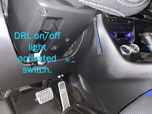

The day light driving light activate (most all Mazda model) when you start the engine and as soon as you place in drive. You can install a separated on/off switch fuse piggyback switch and fuse assembly. It is a simple install and all the parts to do this cost about $20-30 or less depending on where you buy them. The install requires simple basic DIY knowledge of removing replacing a fuse and finding a way to route the switch through the fire wall and mounting the on/off switch. The switch can be mounted just under the dash .
DRL= stands for Daytime Running Lights
possible parts selection
Amazon.com: JABINCO 5 Pack 12V Car Add-a-Circuit Fuse TAP Adapter Mini ATM APM Blade Fuse Holder : Automotive Amazon.com: JABINCO 5 Pack 12V Car Add-a-Circuit Fuse TAP Adapter Mini ATM APM Blade Fuse Holder : Automotive
Amazon.com: XINYIELE 12 Volt Round Rocker Switch,On Off Rocker DC Switch,Round Toggle Switch,2 Pin SPST Switch Button 6A/250V 10A/125V AC Small Electric Switch with Wires for Car Stereo Marine Boat(ON-Off,5Pcs : Automotive Amazon.com: XINYIELE 12 Volt Round Rocker Switch,On Off Rocker DC Switch,Round Toggle Switch,2 Pin SPST Switch Button 6A/250V 10A/125V AC Small Electric Switch with Wires for Car Stereo Marine Boat(ON-Off,5Pcs : Automotive
