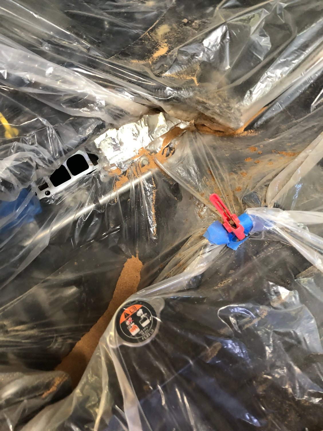

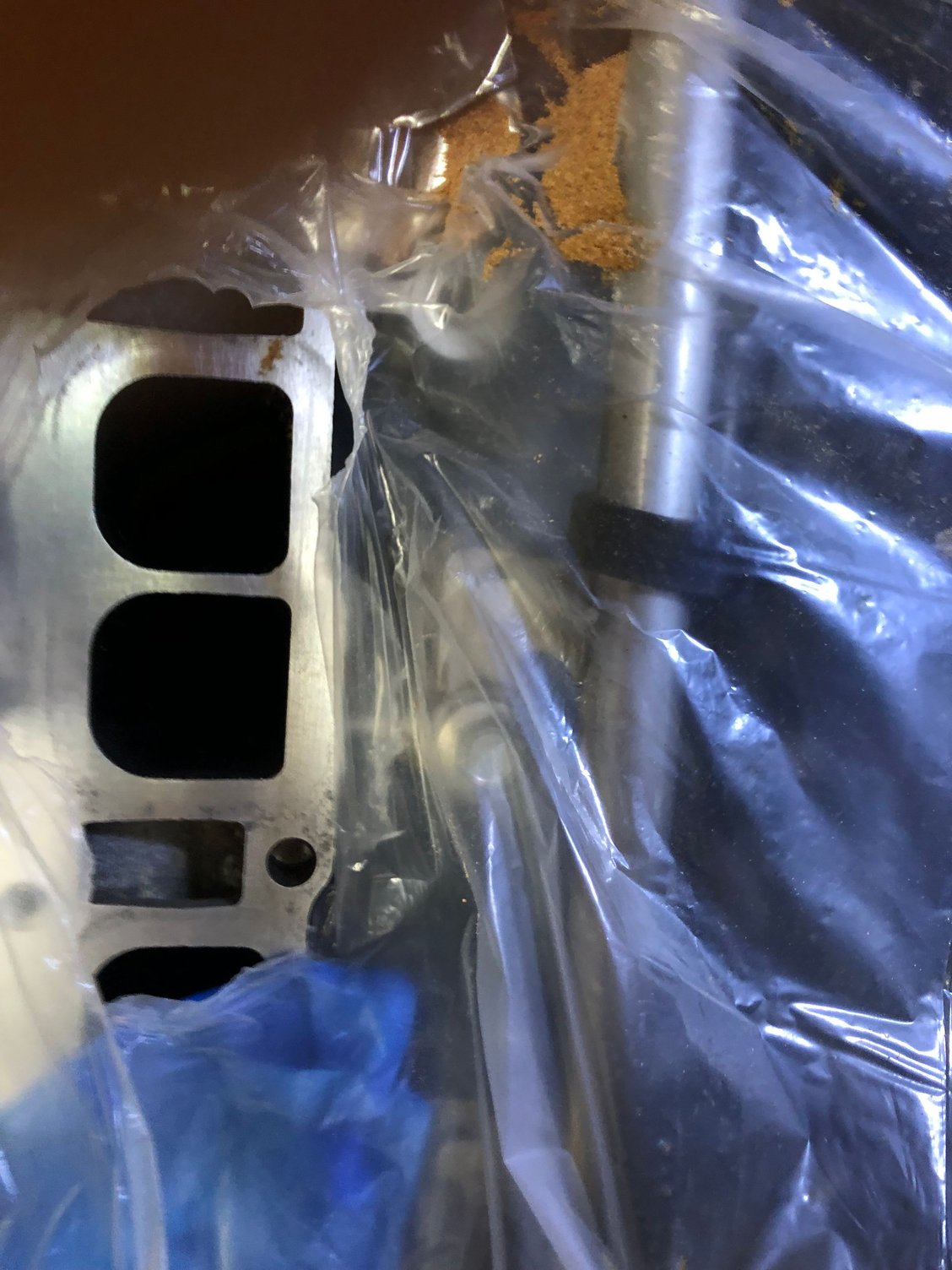

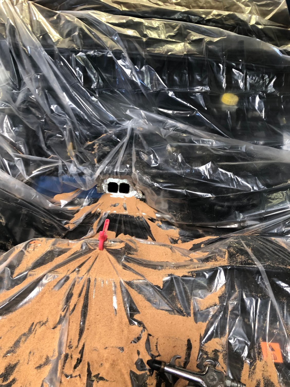

I just finished removing the intake and cleaning my intake valves. There are some good you tube videos, but I’ll just offer my lessons learned.
- replace the intake gaskets.
- remove the throttle body before trying to remove the intake and clean it with you have it off.
- walnut blast for sure, I used the harbor freight blaster and it worked great. I did a little with picks and CRC intake valve cleaner, but 95% was just blasting.
- a 25 lb bag of crushed walnut shells is plenty, you can reuse it just strain it through the strainer cup that comes with the blasting gun.
- cover the engine with a sheet of plastic and mask it to the head and most of the walnut shells will collect in front of the engine.
- I used aluminum tape for masking. Worked great, but clean off the tape residue with acetone.
