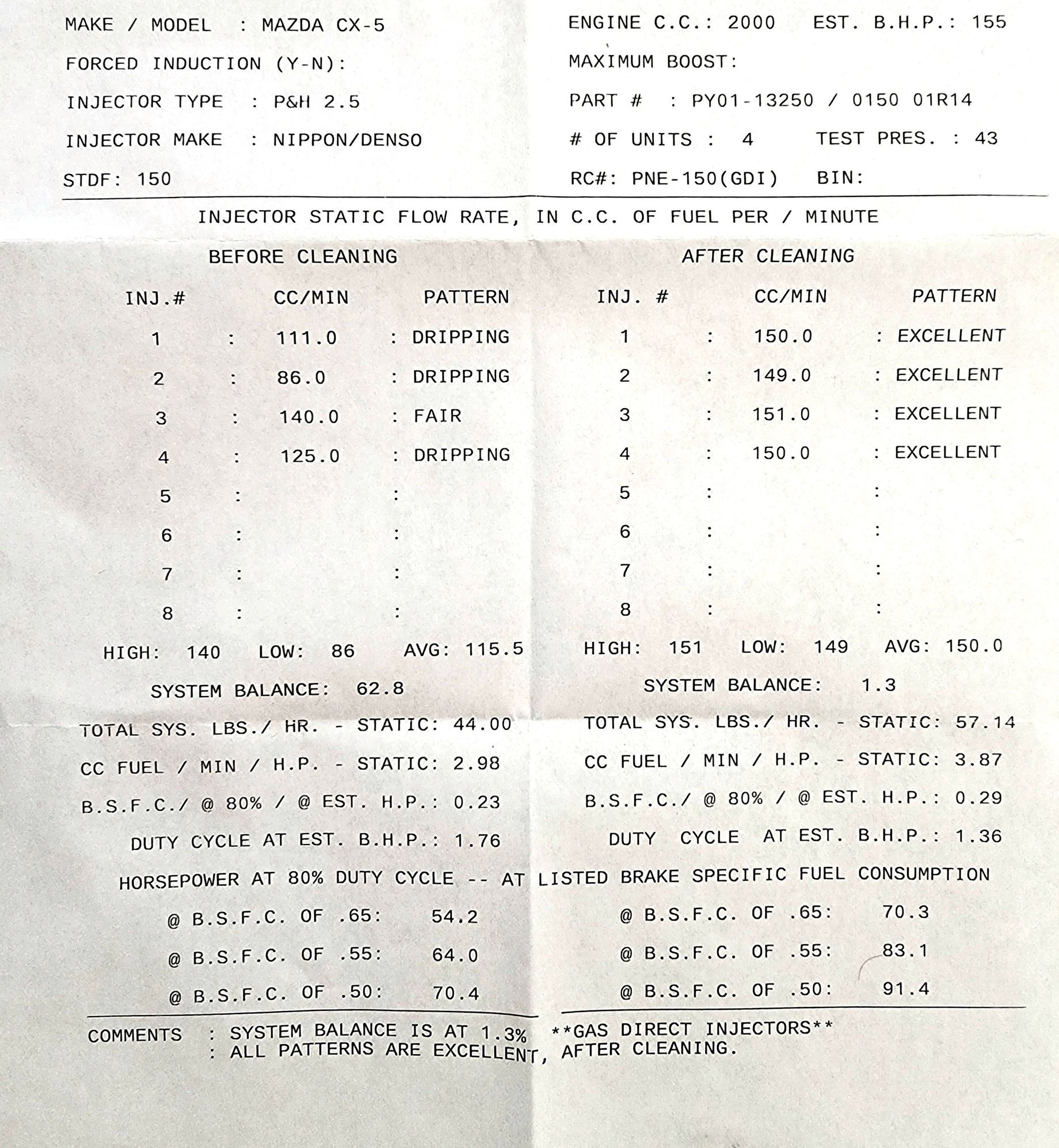

I had a misfire on cylinder 2. Checked the plug and coil and they were fine. Took out the injectors and had them cleaned at RC Injection on Callistos recommendation. Problem went away. The flow rate report showed cylinder 2 flow was half of what it should be.
How was the technician able to check the flow rate and spray pattern of the injector without removing the injector and putting it on a bench tester?

I was having P0302 code everyday after clearing the code.
Swapped coil put in new plug, still code P0302 everyday.
Cleaned fuel injectors, injector 2 had the worst flow rate according to data.
No P0302 code after cleaning injectors.
Cylinder misfire count on cylinder 2 went from ~275 to 350 counts a trip to 1 count a trip.

I did clean the intake valves, so that is another variable that cannot be ruled out. But the injector bench test data pointed to cylinder 2 injector being way lower then the rest.

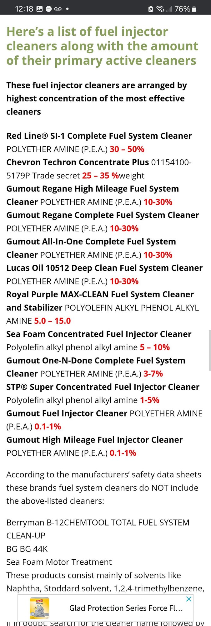

One test I wish would have done, is to see if off the shelf fuel injector cleaners in high concentrations could have dropped the misfire counts low enough to keep the check engine light off.
Do you think the OP could try Redline SL-1 in half a tank of gas to see if the check engine light goes off. Maybe do this a few times over several hundred miles.
Old Jul 6, 2024 | 12:53 PM
Posts: 10,665
Oh this was not your problem?? lol
sure STP or Chevron fuel injector cleaner and or octane booster with 1/2 of less tank of fuel is always a good idea.

You will want the fuel injector cleaner with the most amount of PEA in it.
