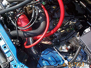

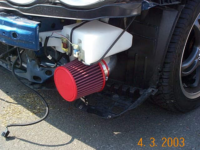

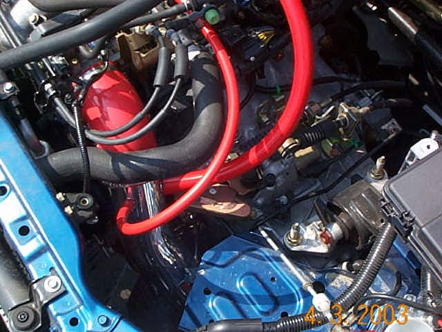

This is what a CAI should be. 2002 RSX Type-S, Injen intake. Came with a smaller washer fluid bottle to fit the filter behind the bumper down low where the cool air is. Granted, on something like a CX-5 if you're taking off road or plan on driving through some deeper water, you risk hydrolocking your engine. Never had an issue in the 2 years I had the RSX though and with an ECU reflash made 20 whp, 15 without.

Also that is a fundamental example of some of the things I posted earlier why they cant work as claimed.

Originally Posted by MotoChooch
"down low where the cool air is".
Attachment 8817Attachment 8818
As a motorcycle rider for decades, I can assure you cool air is not down near the asphalt.
At just 70 degrees, asphalt can get over 125 and when it's 90 or above it can get over140 degrees.
