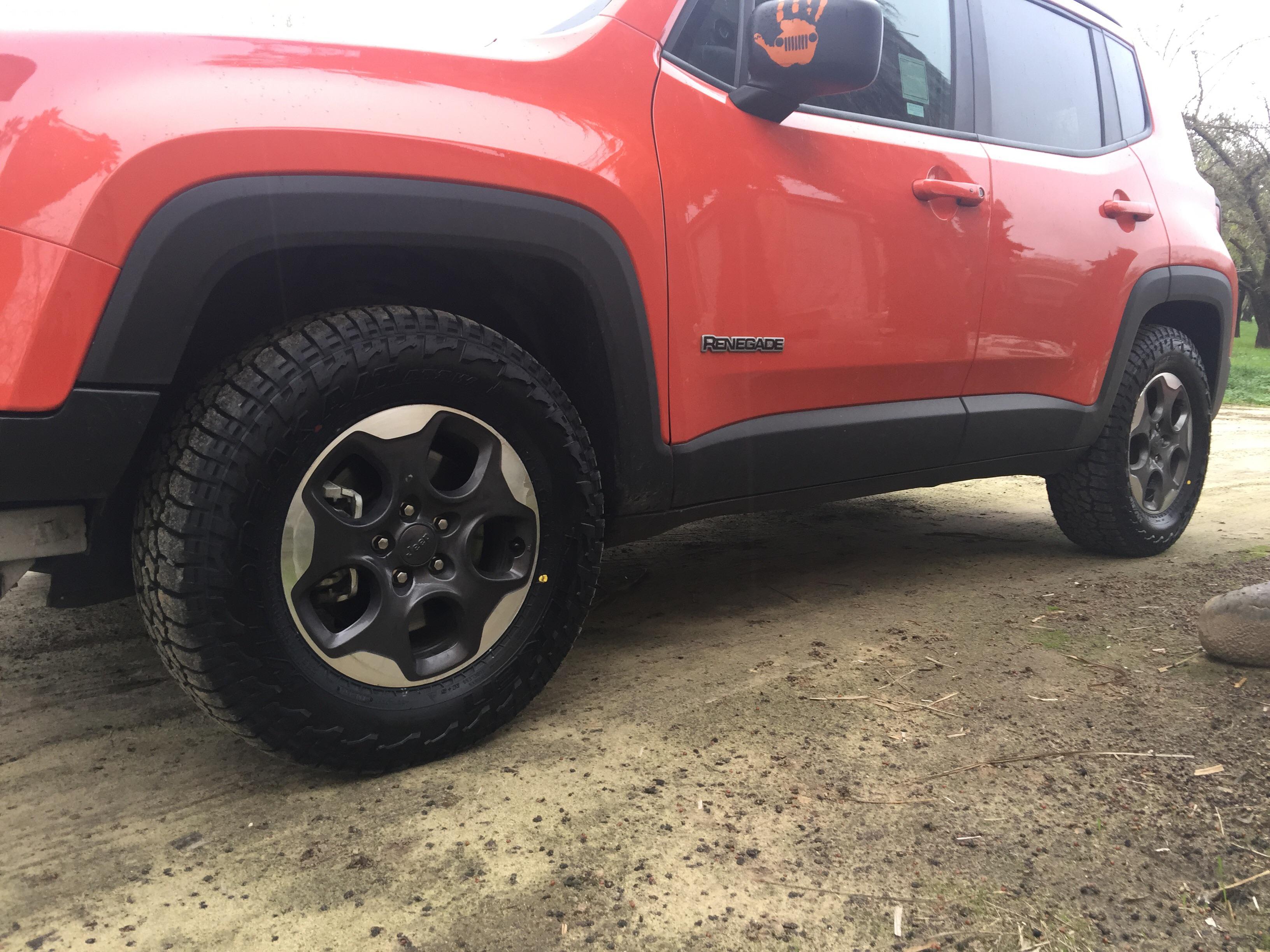

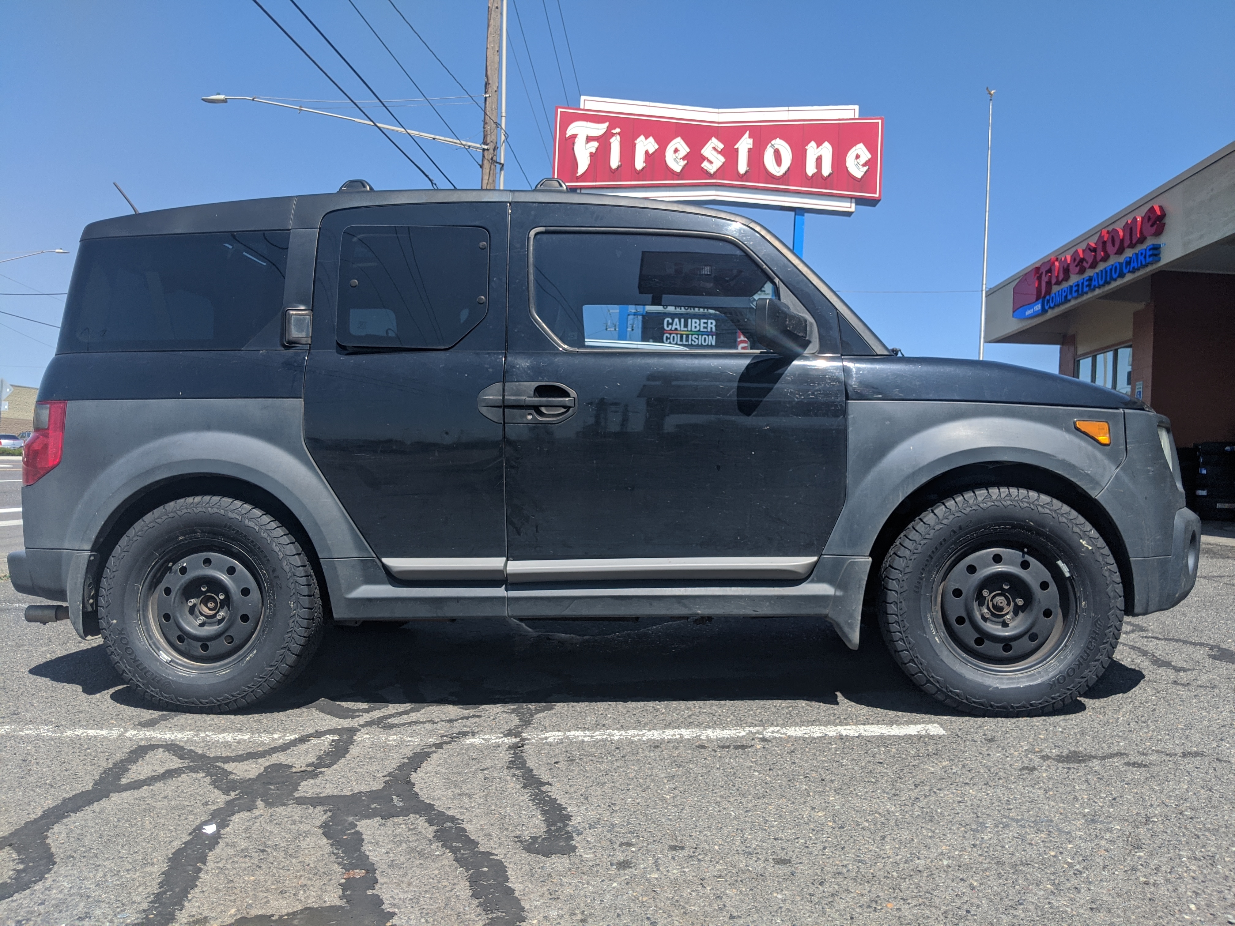

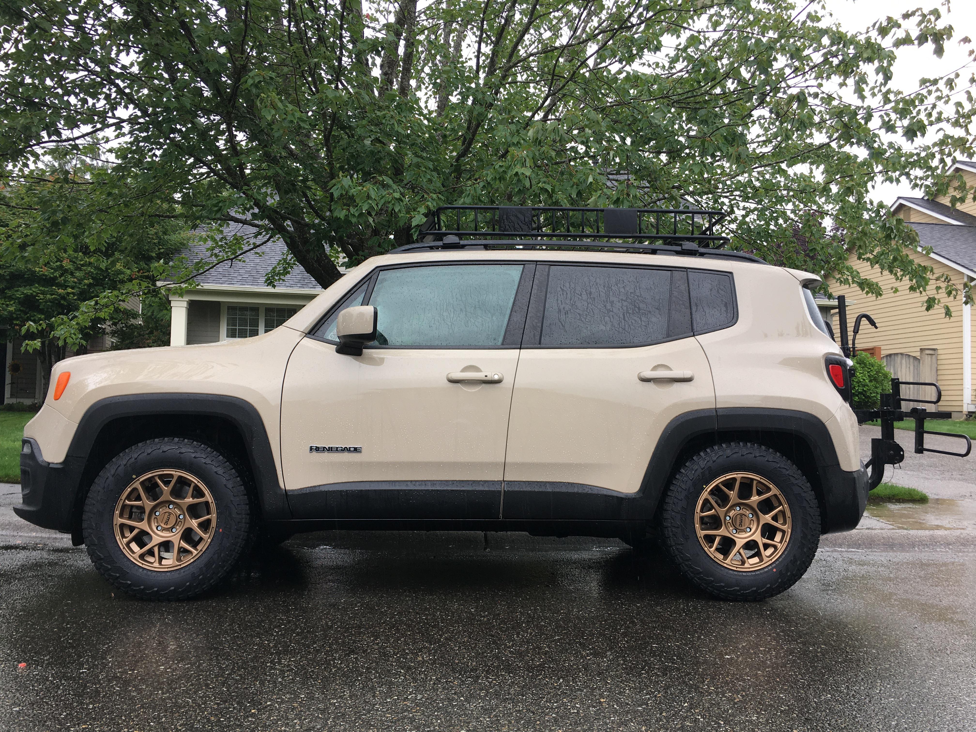

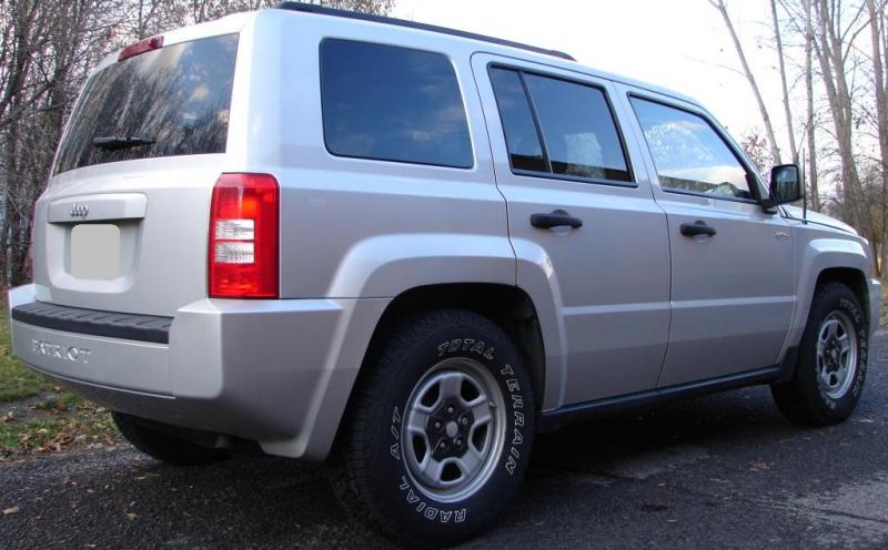

225/65/17 is nothing special, I have it on my '19 CX-5. Not wide enough of a tire to protect the wheel from curb damage, either. I'm looking to change to 235/70/16 on a 16x7, that's about the biggest tire you can fit. Some example pics.
