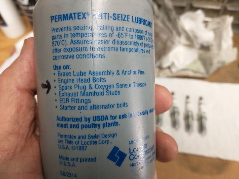

Your choice to use anti seize on the plugs. If applied correctly they offer great thread protection..

I personally only apply the grease to the first few threads on the new spark plug
