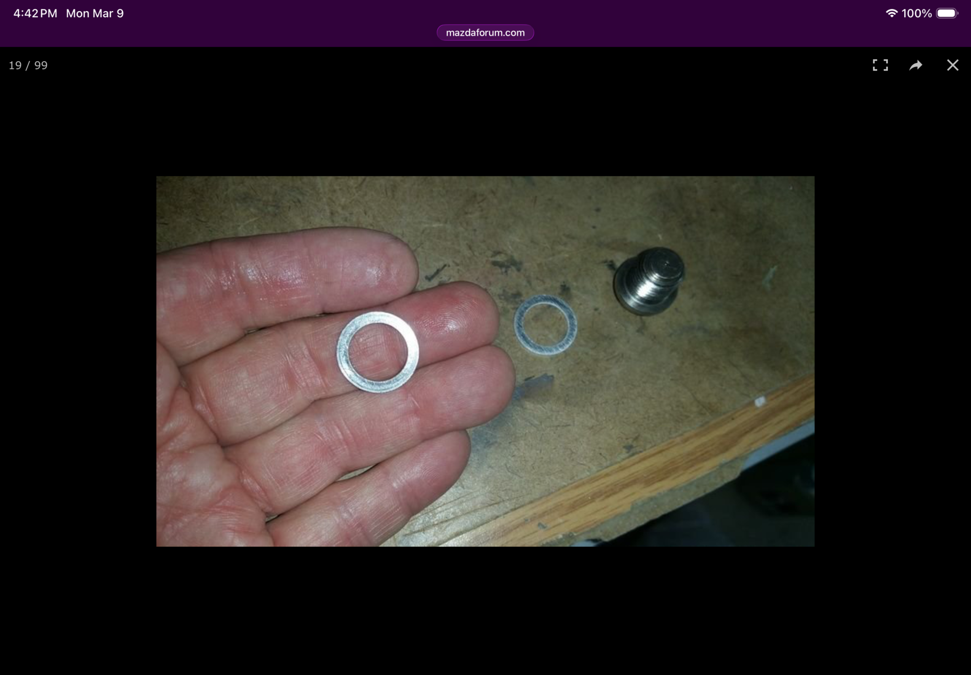

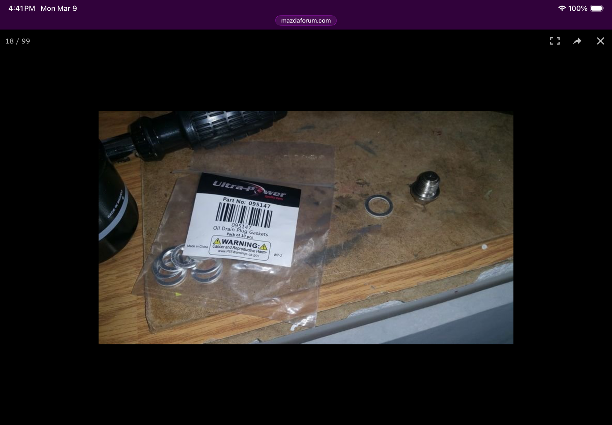

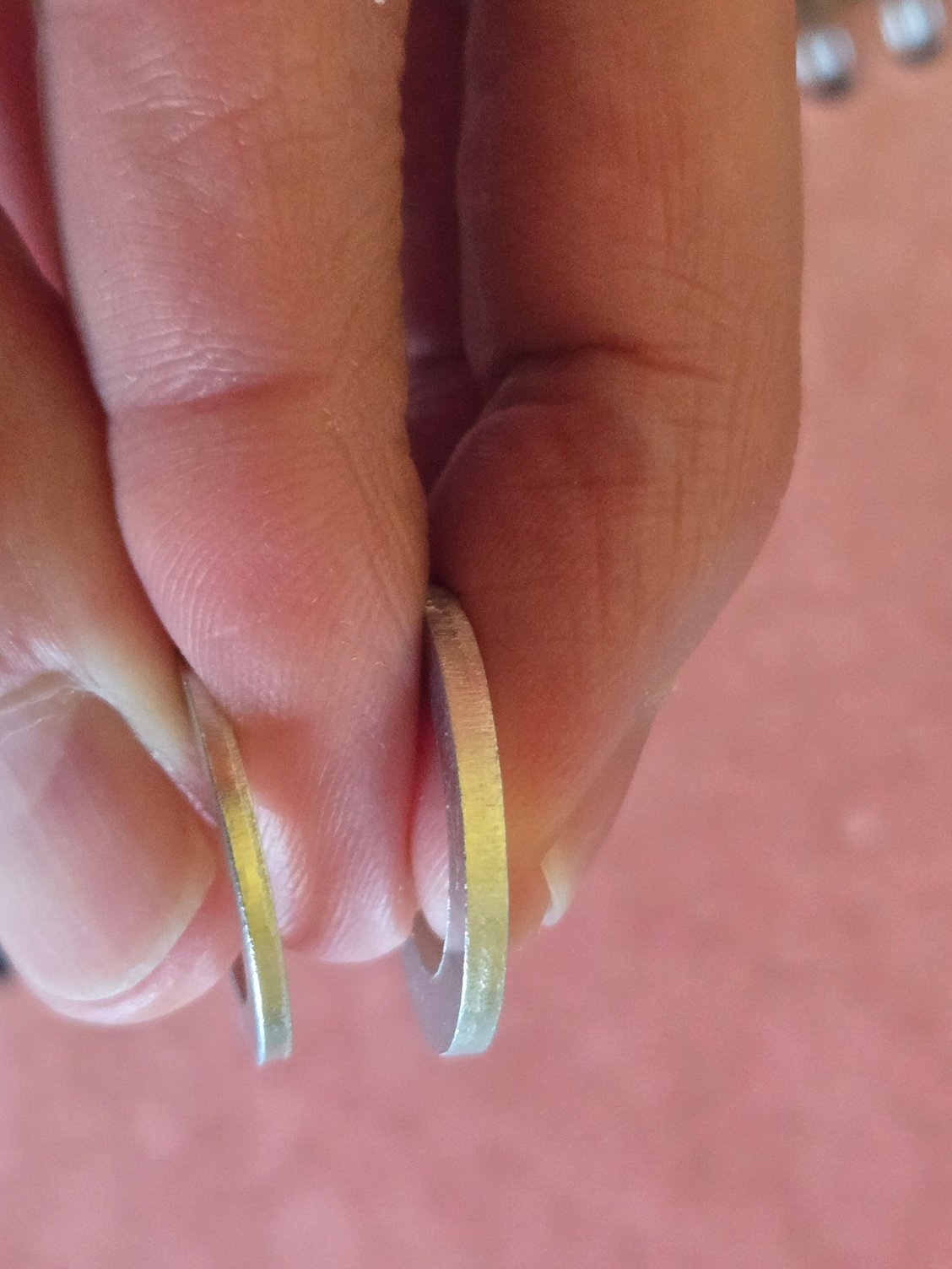

A couple of days ago, I bought a new batch of oil plug crush washers from Amazon. I compared them to my one remaining crush washer. Both have the same internal diameter but the new ones have a larger outer diameter and are slightly thicker. See the pictures. I used one of the new ones today when I changed my oil. The whole washer still fits under the drain plug. It doesn't stick out at all.
Does anyone see any potential issues in using the new ones?
Thanks.

They must fit the shoulder of the drain plug you are using.
Most Mazda drain plugs use are m14 washers.
The thickness is not as important as making sure the washer used fits the drain plug shoulder. If not, then you could if the washer does not center properly when tightening get a leak or damage the pan or drain plug .
I have gotten both the same as you from amazon...it is after all amazon. The Company same package 2 different sizes like in your picture was AOIT

" fits the drain plug shoulder. If not, then you could if the washer does not center properly when tightening get a leak or damage the pan or drain plug ."
The exact size of the new ones are :
OD: 22mm; ID: 14mm; Thickness: 2mm;
The old ones have an ID of 14mm. I don't have a calipers so I estimate OD at 20mm and Thickness at 1.5mm
Since the new one is also 14mm Inner Diameter, it seemed to center fine. I would think the centering of the washer would be solely due to the inner diameter. The whole new washer fits completely under the "shoulder" of the drain plug. It didn't extend beyond the shoulder. I hope I'm explaining this ok.
Edit - I just went onto Amazon and found the exact OEM size and ordered them : OD 20mm, ID 14mm, Thickness 1.5mm.
I assume I'll be good using the OD 22mm until my next oil change.
