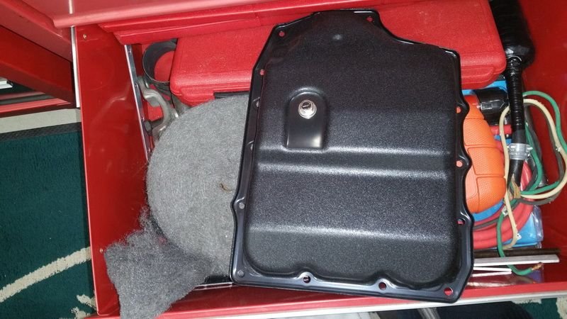

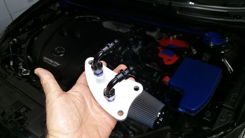

Here is the pictures that I could not send you through the Private Message.
No need to respond to me here but you are still more then welcome to PM me anytime!
Old Sep 10, 2020 | 05:52 PM
Posts: 7,847
Callisto, did you buy that adapter plate or make it yourself?
Old Sep 10, 2020 | 06:26 PM
Posts: 10,573
Likes: 224
. Yes. It is a slight copy using the actual adapter we use from the Transmission service machine here in the shop for replacement of complete fluid for MADZA trannies. I cut mine from aluminum and drilled and tapped larger threads for fitment of AN hose adapter for a higher flow capacity to use a remote cooler and spin on oil filter. This way I can bypass the really small water oil cooler exchanger and really just eliminate it altogether.
