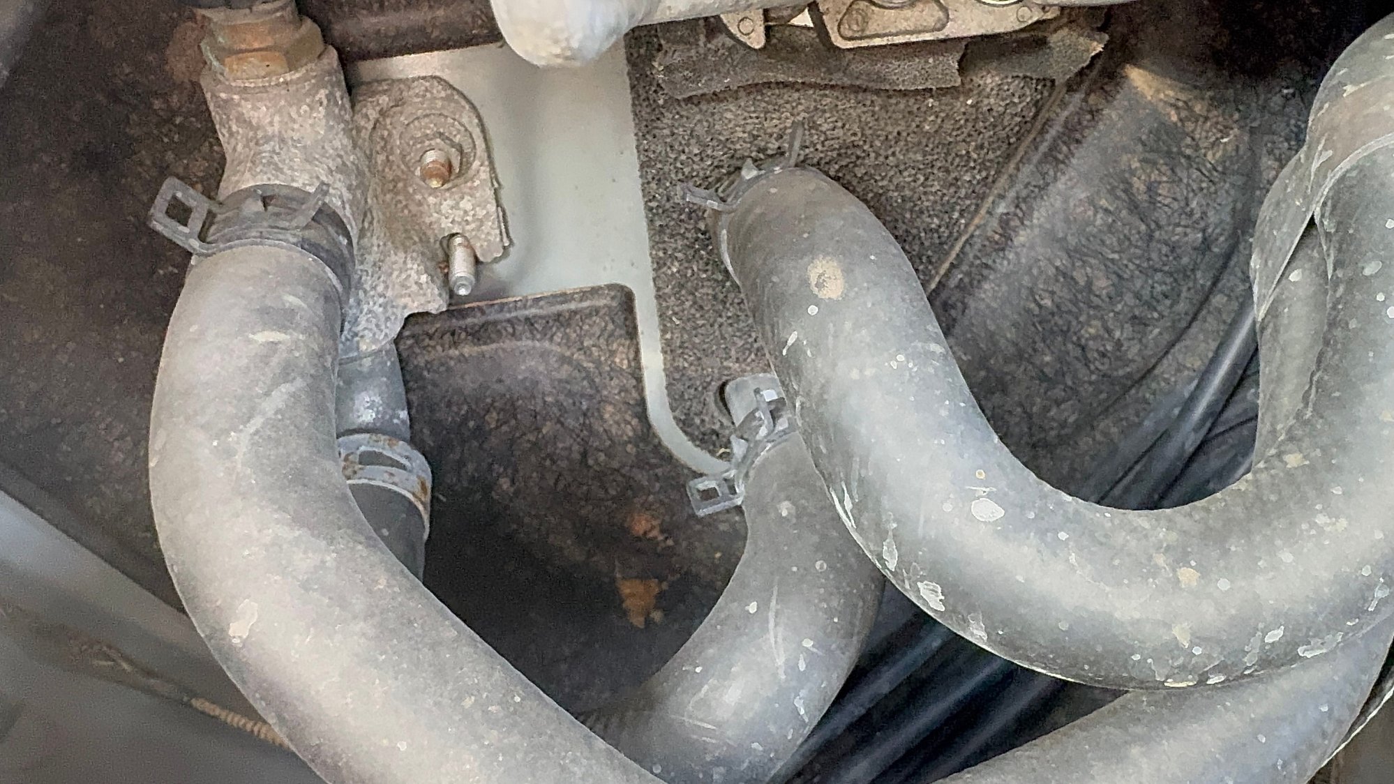

Any idea which hoses I would need to disconnect? I think the top right is the inlet because it was hot to the touch. Not sure what other hoses to disconnect to do a heater core flush
Old Nov 24, 2024 | 01:43 PM
Posts: 10,573
Likes: 224
heater core is on the right side of your picture
