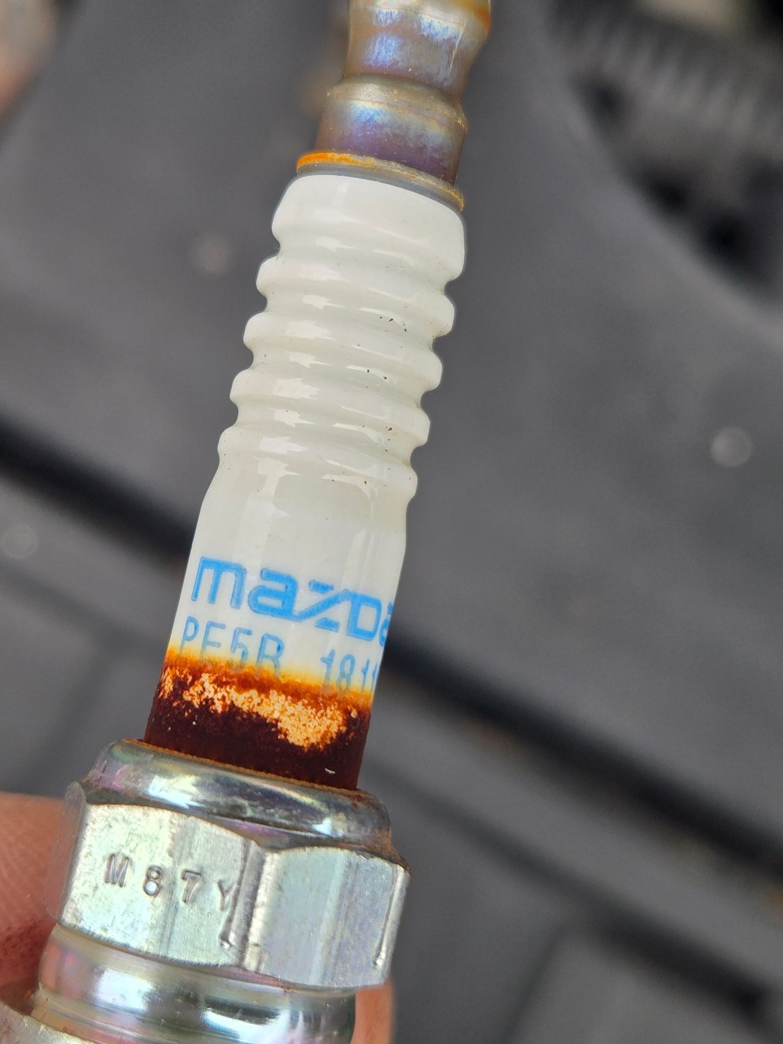

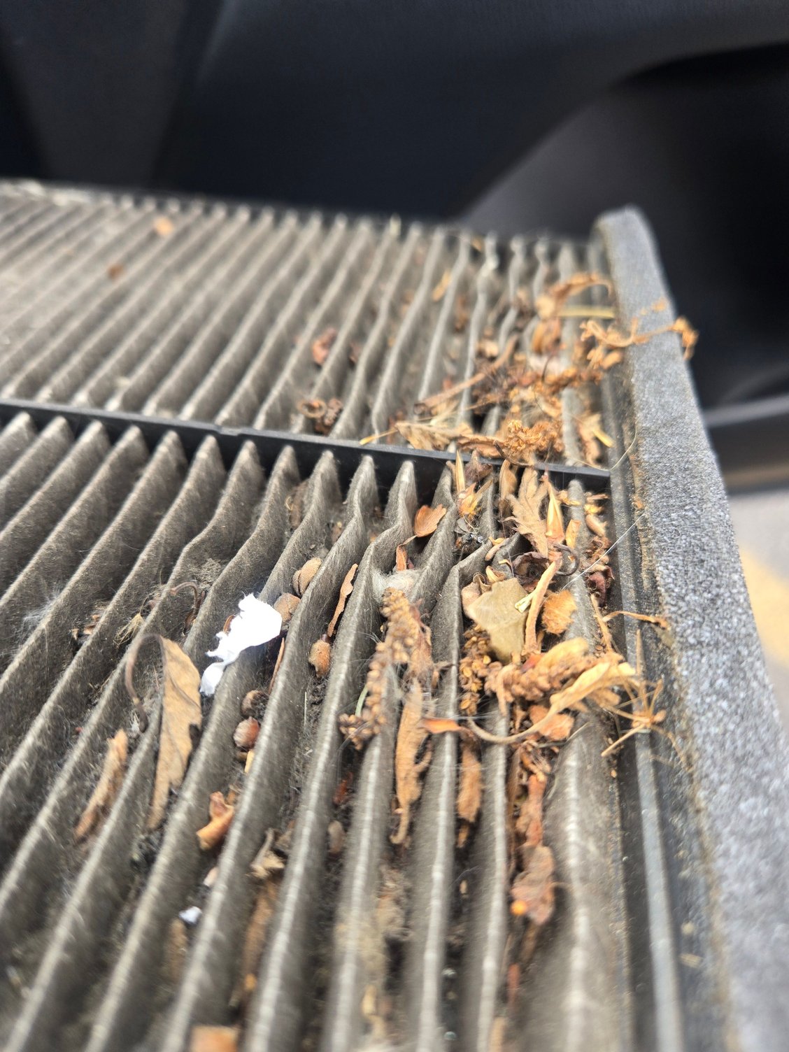

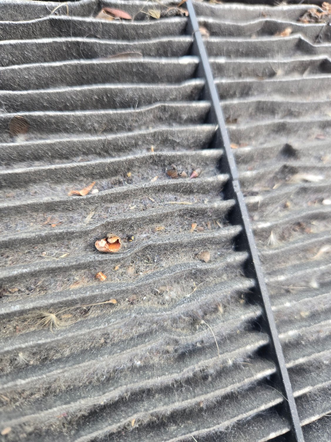

I'm new to Mazda and picked one up a 2018 CX5 off dealer, that has 127,000 miles...
First thing i did was to replace oil n filter and then cabin filter which i feel it was original it was so plugged up. And today i removed the spark plugs which looked original, also and changed them.
So now my question is the transmission fluid n filter. -
As the other day while using cruise control it down shifted to get up a hill but after the hill it wouldn't upshift and was turning over 3,000 RPM, and then i had to slow down and then speed up again to get it to shift correctly .
So im thinking its beyond just draining and fill , and that i need to remove pan and also replace filter.
So what type of fluid and how many quarts may it take 5 or 6 ?.
Here is a few pics of old plugs and cabin filter.

If the cabin filter was that dirty I record a HVAC system cleaning. Easy 30 bucks DIY friendly procedure
And the boots and springs on the spark plugs should have been replaced with your new spark plugs

I would be somewhat concerned if I bought a car with that level of neglect in its servicing. They just drove it until they were tired of it. How often did it even get oil changes? I would change every possible fluid you can.
Old Jul 15, 2025 | 12:15 PM
Posts: 10,652
Likes: 232
Welcome to my world of 1 out about my guess 20 vehicles that come into our service shop.
This is not uncommon nationwide.
Most of it stems around cost of service. It is a balance of people not realizing the downfall to not keeping up on servicing and that a vehicle is an ongoing expense and investment.
Old Jul 15, 2025 | 12:42 PM
Posts: 1,865
Hindsight for Carls2018 now, but those items should've been checked before purchase.
Dirty cabin filter and old plugs would be a good indication of the lack of service maintenance.
Mazda recommends cabin filter change every 2 years though I inspect mine 2x a year and change it at least once, plug change every 75,000 miles.
Would be best to get all your fluids changed including engine, transmission, coolant and brake.
As Callisto said a percentage of people never maintain their vehicles and this likely one of them which generally doesn't bode well for longevity, but you never know.
