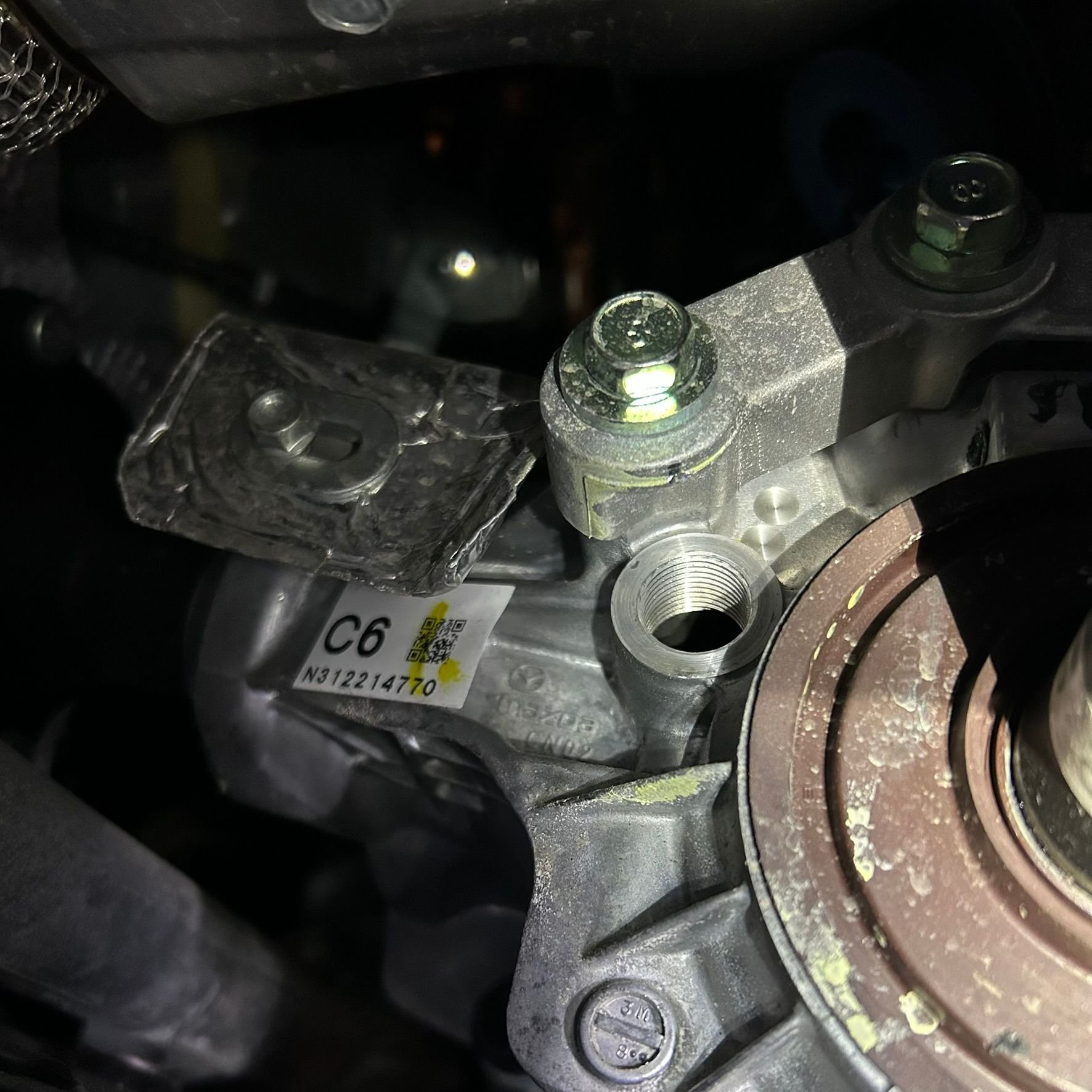

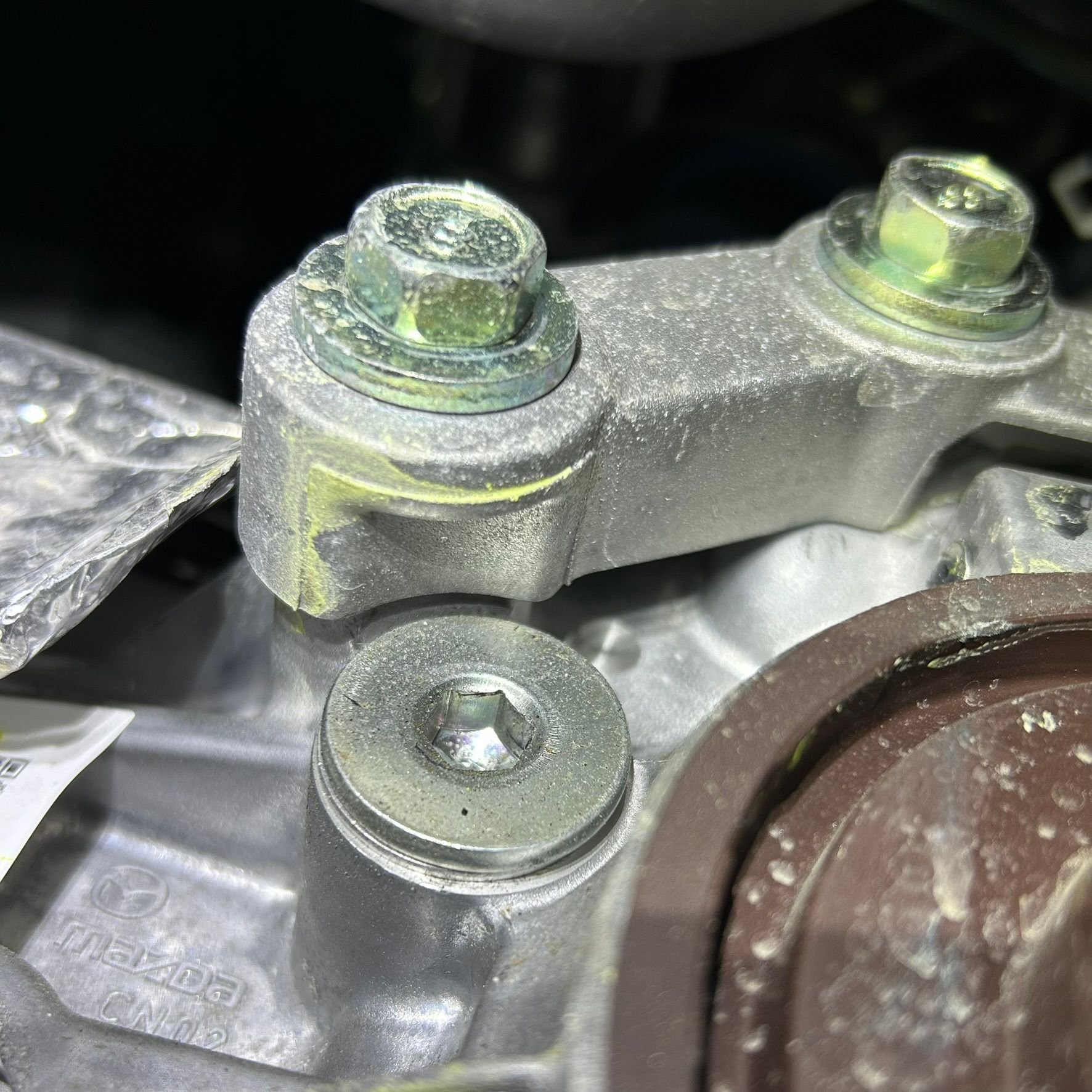

I have a 2024 CX-30, and the front transfer case fill plug blockage issue is FIXED. There is a cutout for the plug to come out without interference. Just FYI.

Sorry I don't understand what I did wrong. I don't have before pictures. I also didn't copy anything, these are pictures I took myself, of my own car. Not sure what warranty has anything to do with it. Yes, I am a one sentence kinda guy, unless I need to expand on something, but in this case, the pictures should suffice.

You did nothing wrong as a service Tech among other attributes I was interested in this thread and knew what you were trying to convey.
So let me expand what I know now. On some model and a few years of productions Mazda's the use of a normal fastener was secured in that location and blocked easy access to the fill fastener. So, there is a factory bolt like you pictured specifically design and used at that location to allow free access to the drain and fill Fastner of the transfer case. For the sake of not getting into a debate I can't remember the last time I physically changed the fluid in any transfer case and often assign that to my Techs or just a mechanic as it is a no brainer service. I never had any of them come to me and state they could not access the drain bolt. But asking my lead Tech he said he has had a couple times but it is still no problem just takes and extra 10 minutes of work and that special fastener is not necessarily needed if you know what you are doing. So based on your thread and my dudiligence to find more info I just order a few to have in stock for the future should a customers have a Mazda of several years needing that special fastener.

No worries. I figured that those who know, know. Those who don't, either are not affected, or not worried about it.
Most older CX-30 had a bracket blocking the removal of the fill bolt. A lot of people wanted confirmation that the issue is fixed in more recent models. I just found out that 2024 MY is now fixed, so I posted about it.

Actually, if someone here isn't already aware, this issue has NOT been fixed on the 2024 NA CX-30. It is only the turbos that do not have this issue. At least it wasn't corrected on my 2024 CX-30.

There is no documentation from Mazda one way or the other. (there may have been a TSB but I causally looked and found none)!
Its not an issue for one thing that would be a problem this is more of a service inconvenience and servicing inconveniences have been on vehicles for decades. It why I get the $$$ to do servicing even with them.
