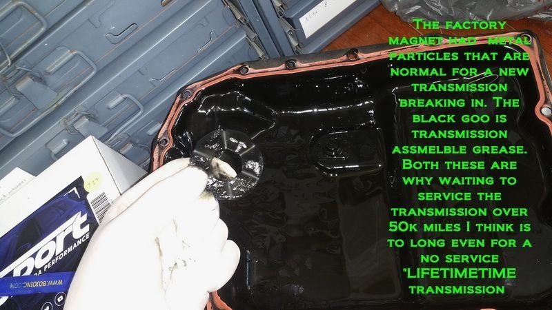

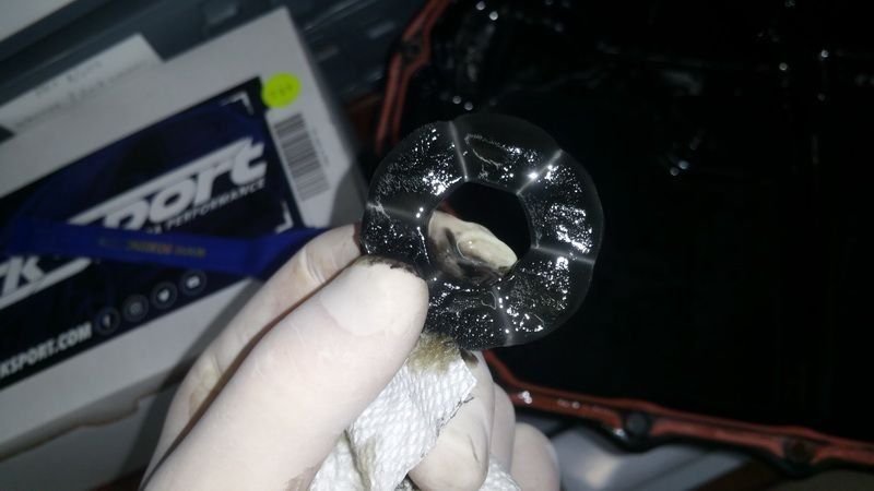

Old school thought was dating back into the 90's,80s, 70's all the way back to 40's was that the automatic transmission seldom needed oil change service. ALL automatic transmission wear as they acquire miles and shed material as some contact parts constantly wear out under normal operation. Like the clutch-pack and friction materialled parts. Those transmission filter do not do the best job of catching all that material. Fortunately the pan sump does not have windage that truns up what settles in the pan under most vehcle operation. But nevertheless it accumulates and some of that accumulation is metalic. See where this is going? So is that material that is metalic from normal wear is picked up from the pan it will circulate through the complete transmission and all the sensitive operation parts like the valve bode and solenoid and pumps. Liquid sand paper LOL
The good news from what I hope I am scaring the BEJESUS" out of you is that will a regular servicing as I outlined your fluid will have a more cleaning operating environment and will actually go way past the warranty or estimate miles 100K Not thinking about what I posted you are more likely be in the growing percentage of owners having something go wrong with your transmission at some point in its like.

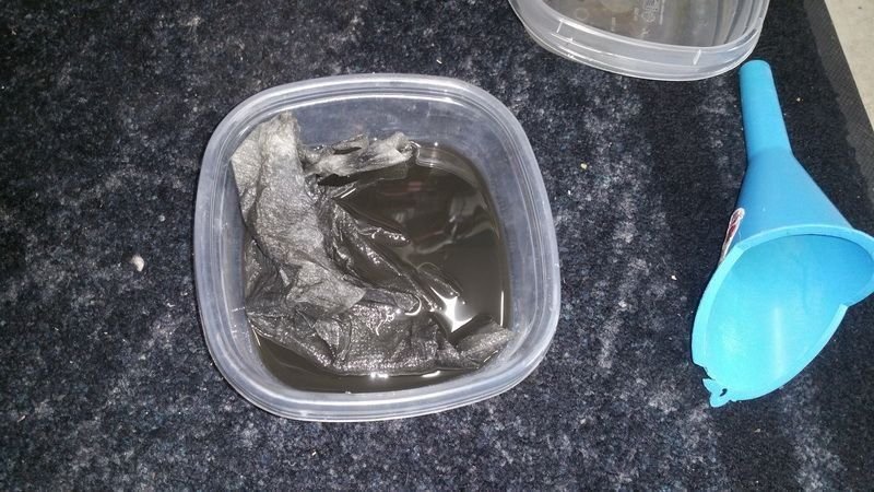

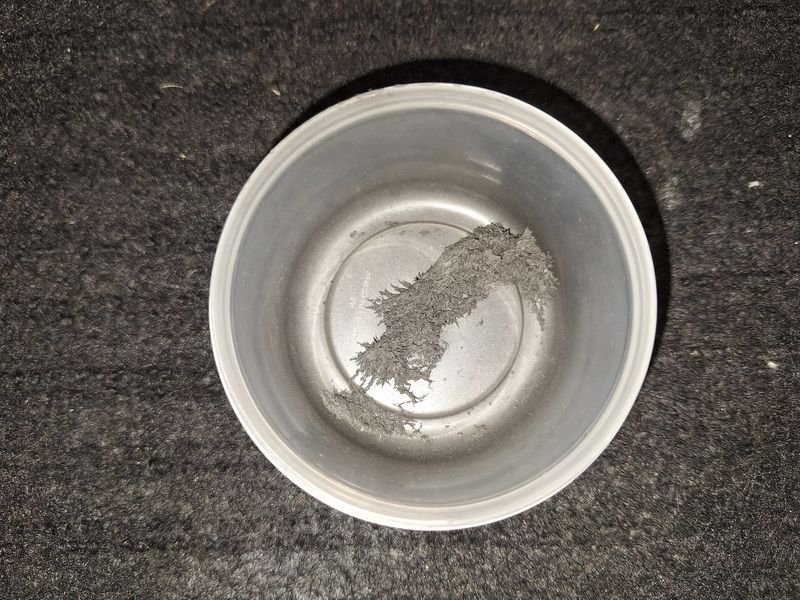

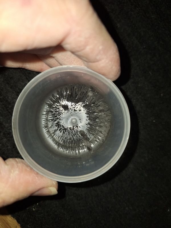

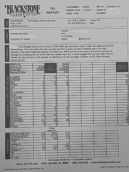

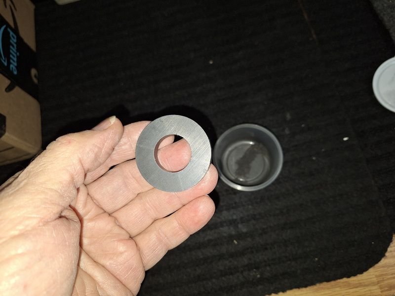

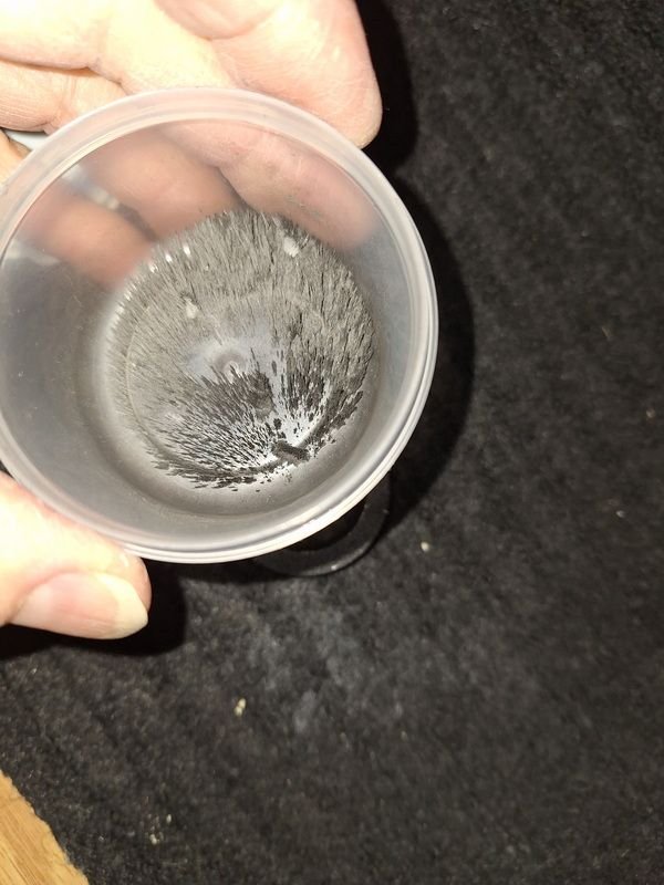

This is what I removed when I did my first transmission pan oil and filter service. I also had the oil analyzed (see my thread ).
At this point with my frequent oil and or oil and filter service my last oil sample only showed the oil and even recommend increasing my miles of oil service. But oil is cheap, and I will stick to my own personal oil service/ LOL

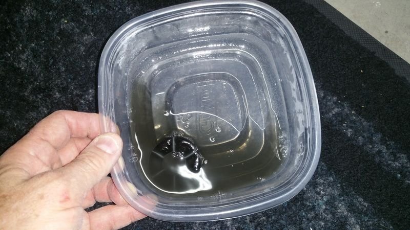

Mazda3 Things I like to do - Page 19 - Mazda Forum - Mazda Enthusiast Forums
The water mentioned was some droplets left when I rinsed the long spout funnel to refill the transmission. WOW caught me off guard, but it shows how good the oil analysis was.

I have heard very good things about Blackstone Labs - at least pertaining to motor oil analysis. I have never used them myself, though.

That was a lot of metal that you got out of your transmission! I suppose that you drive it pretty hard.
Old Jan 26, 2025 | 12:01 AM
Posts: 10,593
That is a normal amount found in most transmissions ! It is more when a basic service goes over 50k miles or more .
