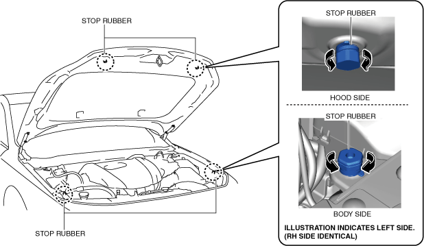

how does one adjust the front height of the hood where it joins the front bumper upper facia?
Thanks for any responses on this.
Did you try to turn stop rubbers?
If there is only height difference there is no need to take it to body shop.
Thanks for the reply.
That is the issue--the passenger side front of the hood is below the front facia by 1/8"-1/4,", the driver side is above the facia by the same amount .
Do you have a pic of where the turn stop rubbers are located?
piс is literally in the post, maybe your browser blocks cimg6.ibsrv.net ?
Alternative link https://ibb.co/k4T4vG7
