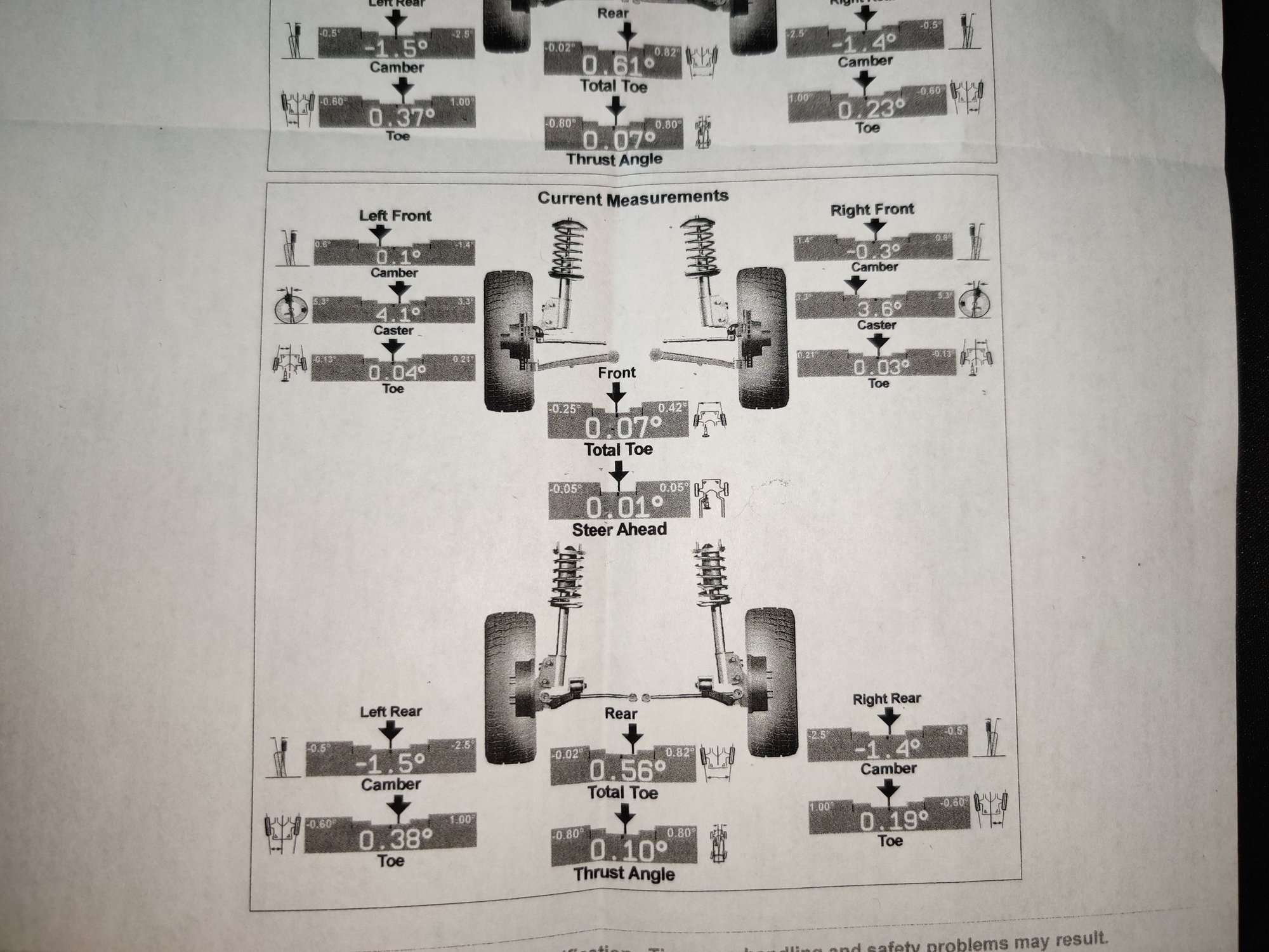

Bought a new CX-30 and loving the turbo engine!! However car pulls to the left and the dealer did an alignment which helped correct the total toe number and thrust angle. Car still feels like it pulls a bit to the left and wondering if the difference in front camber is why? Dealer says the car needs some road time to help things "settle in", is that an accurate statement? And should I be concerned about the difference in front camber (left is .1 right is -.3 degrees)? Below is the after alignment measurements. Thanks!
Old Jul 22, 2021 | 05:36 AM
Posts: 7,847
100% should never pull to the left. Slight pull to the right is preferred.
Take it back, complain again.
