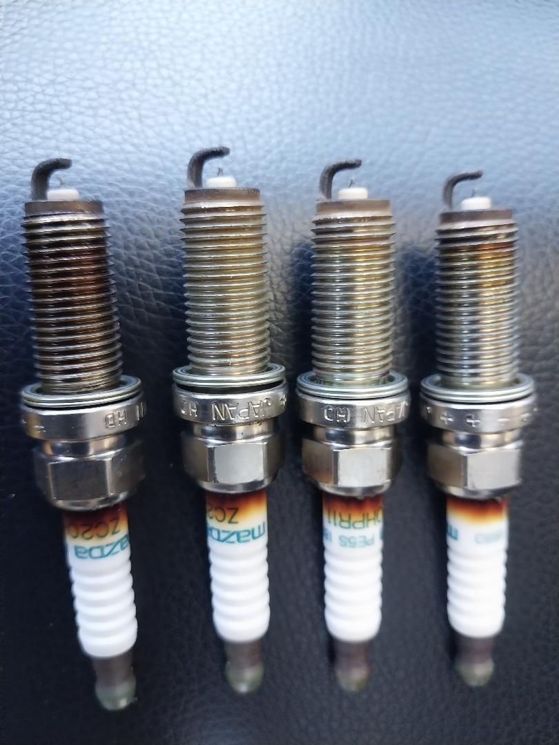

The old ones did not look too bad (photo attached). The spark plug in my lawnmower looked worse after month or two. Haha!!. I did notice that the car had a bit more pep when merging onto the highway with the new plugs installed. The serpentine belt did have a bit more wear on it than it should for the mileage, so I viewed it as cheap insurance by having it replaced. I kept it as a spare and will stow it under the passenger seat. I will have the A/C belt replaced at the next major service. What surprised me was that the independent shop said that the rear differential and the transfer case are "dealership only" items and that they did not have the proper type of oil that our car requires (kudos for his honesty).

The old spark plugs.  Not too terrible for the mileage on them.  Glad I did not wait until 70k, though.
The new spark plugs - NGK.

The spark plugs are clean but showing a lot of heat transfer. Its normal and another sign that the spark plug should have been considered changing sooner. Without shing a bright light down inside to see the complete insulator it hard to tell complete information for reading spark plug. And that the engine was idled down before shut of changes the reading of them for normal engine speeds driving.
