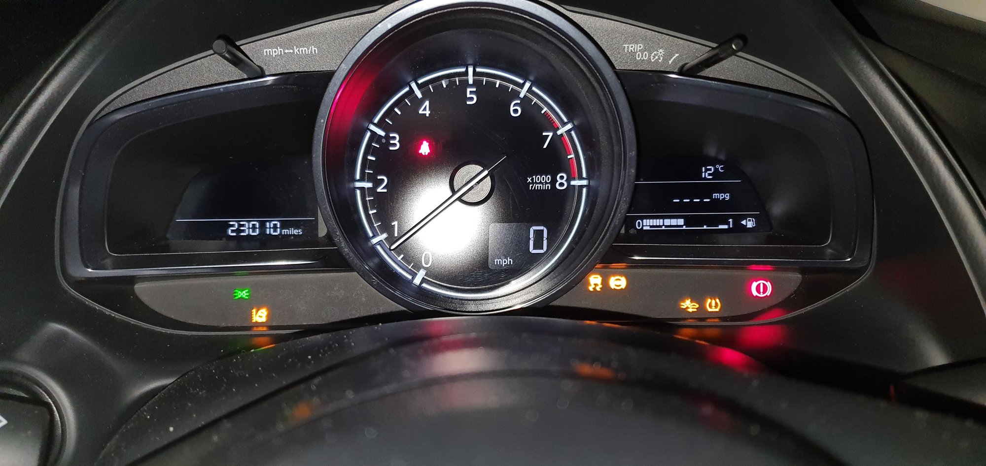

Just bought a2018 cx3 2.0l petrol low mileage. 23000.
Been getting amber lights. Cleared with obd and came back 2 days later. The out of lane, abs, and 3 others. Any ideas?

Sorry i mean i plugged in an obd reader and cleared all the trouble codes first.
The amber lights are lane assist, anti lock brake, electronic stabilization skid symbol, some sort of rear sensor shunt symbol, and tyre pressure
5 amber lights

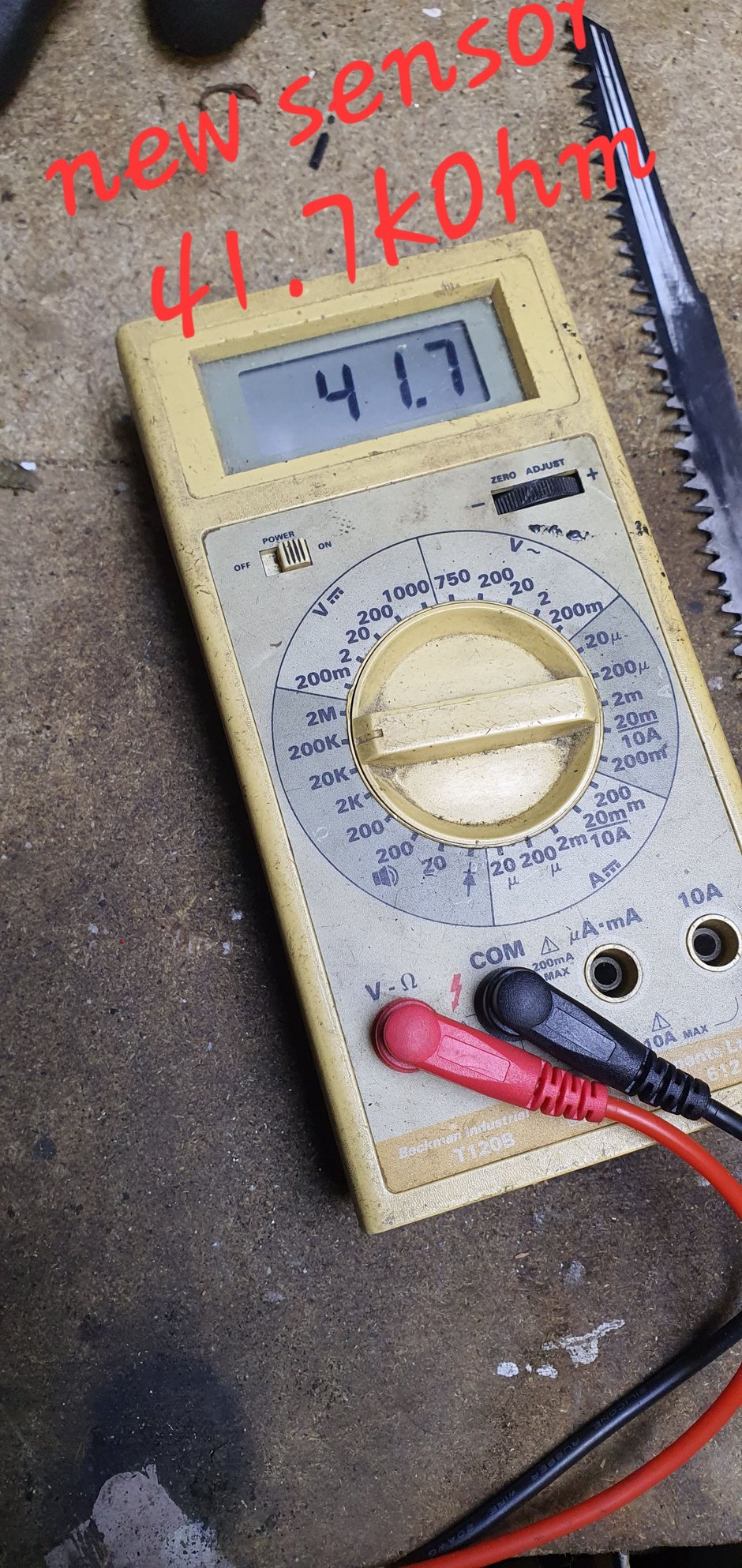

Default Resistance reading of RH rear ABS sensor
So i found the connection under the trim on the rh rear seat belt area... The resistance reading was 49 ohm and slowly increased to about 56 ohms over a15 minute period. This strikes me as too low which may account for the fault codes. Does anyone know what the correct reading is? I read other reluctance type ABS sensors are normally between 800 -1500 ohms. ??

So having bought the part. RH rear wheel speed sensor harness from Mazda directly. I tested the resistance on the new one it was massively higher. 41.7 kOhms against 50 Ohms on the old one.
When replaced the errors disappeared.
I cleared the DTC memory one last time and now all good.
