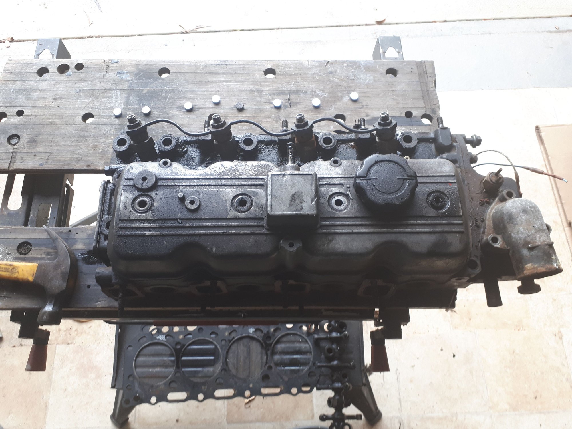

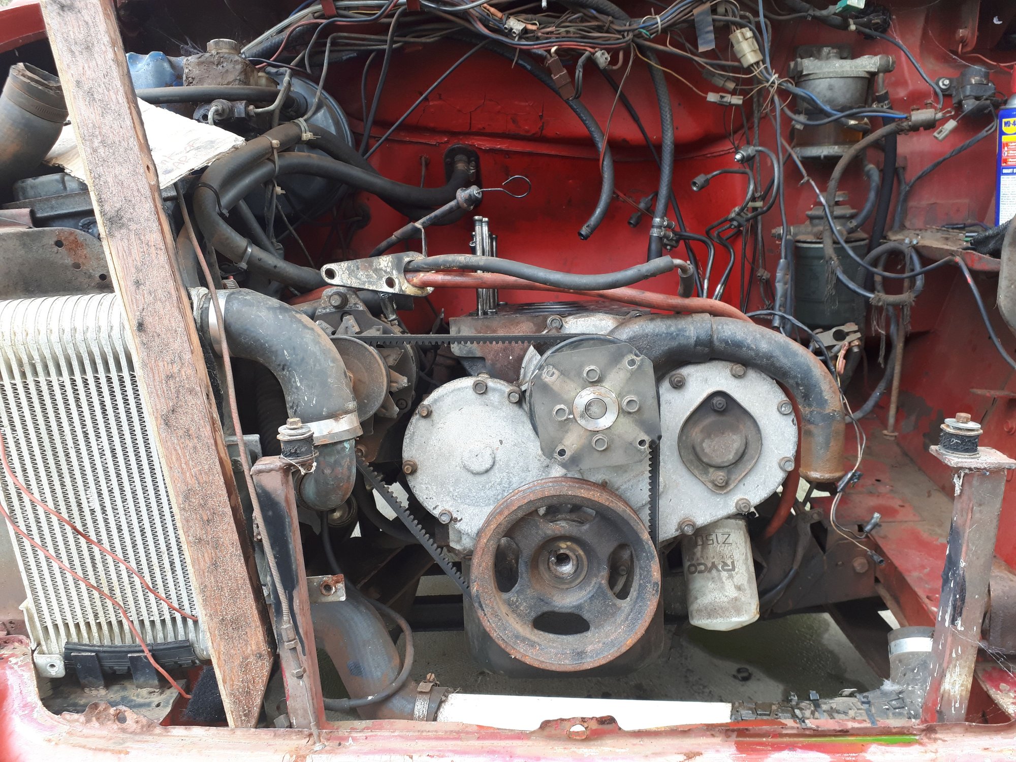

Which Mazda engine is this?
Morning, I have a Mazda engine fitted into an early Transit van but I've not been able to identify it to buy parts, can anyone help me?
. All i know is that it is a push rod engine, bores are approx. 88.3 cm's, the push rods are 182mm and the engine number is e13561. One dude thought it was an HA or ZA engine but the two lengths of push rods for listed for those are 206 or 218mm.

Mazda / Perkins 2.2L Diesel
Old Apr 21, 2021 | 08:50 PM
90-B2200's Avatar
Joined: Oct 2020
Posts: 239
From: Maryland
A diesel variation of the 2.2 L (2,184 cc) F2 which shares its 86 mm × 94 mm (3.39 in × 3.70 in) bore and stroke. Displacement: 2,184 cc (2.2 L; 133.3 cu in) Power net ) 51.5 kW (70 PS; 69 hp) (JIS net) @ 4050 rpm Torque: 142 N⋅m (105 lb⋅ft) - @ 2500 rpm Power net 58.1 kW (79 PS; 78 hp) (JIS net) @ 4050 rpm Torque: 171 N⋅m (126 lb⋅ft) - @ 2500 rpm

Thanks mate, they any good? Worth a head gasket and set of push rods?

I have no knowledge of the reliability of the engine. I just saw what looked like diesel fuel lines in the picture you posted then did google search until I found matching pictures
