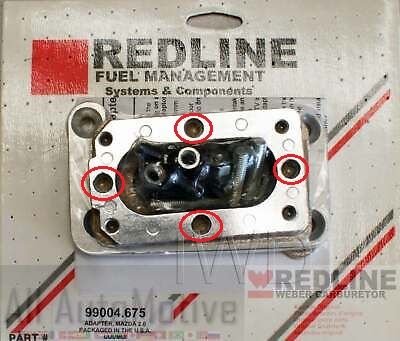

Here are the 4 screw locations (circled in red) that can "raise" the lower adapter plate off of the intake manifold sealing surface, IF they are too long, OR if the recessed hole that they are located in......is machined too deep.....effectively lowering the screws down to the point that they go completely through the lower adapter plate, and contact the intake manifold surface........

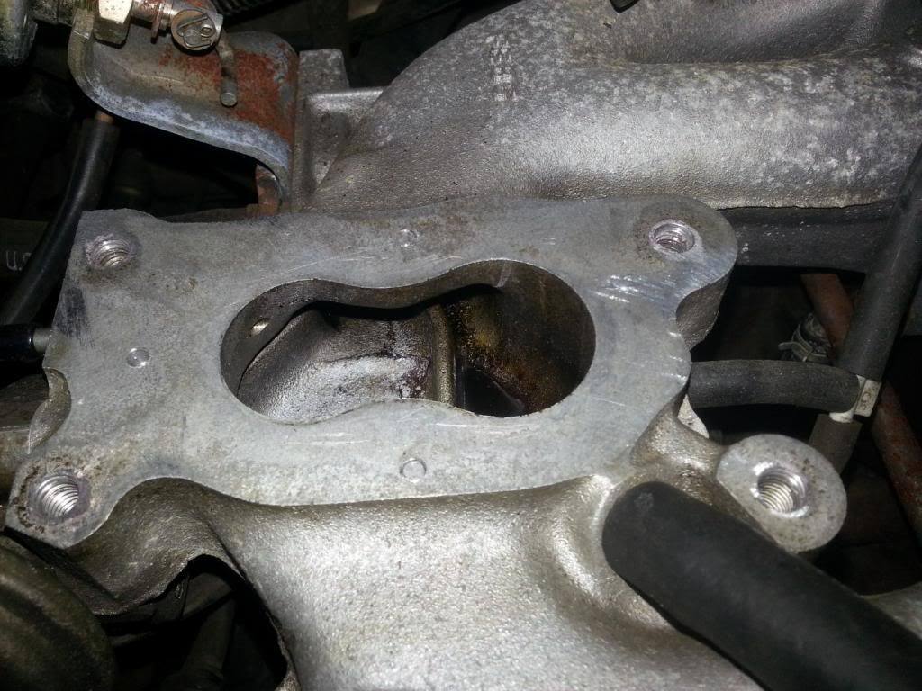

Yep. Looks like one of the screws marred the adapter plate.

Yep! But that is where one of the carburetor studs was tightened down too much......and probably lifted the upper adapter plate to create a vacuum leak.
While you have it torn down that far, go ahead and remove the lower adapter plate to check below where the 4 cap screws (already removed in your photo) thread into, to make sure those weren't contacting the intake manifold also.......and creating a vacuum leak also.

I checked that when I had both adapter plates off, no marring there. However I have noticed what exactly caused my vacuum leak. Apparently those four bolts on the first plate backed out, and we're causing the adapter plate to the intake to not be seated properly thus the whistle and leak.
