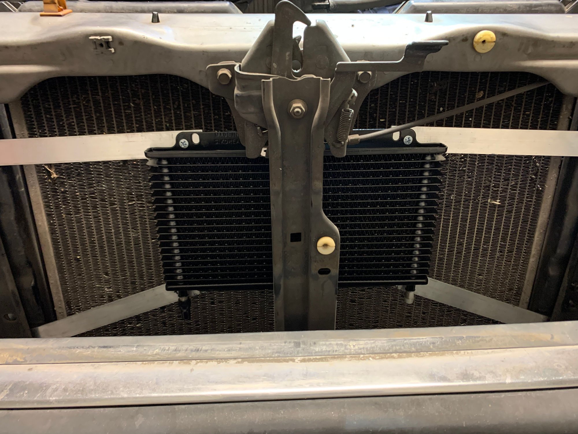

I was able to successfully put in the oil cooler. I purchased a Hayden 677 Rapid-cool oil cooler from amazon ($38). The description said it had 3/8 fittings, but it was closer to 11/32. I was able to achieve what I wanted and make the connection without using reducers. The 11/32 hose was a tight fight on the transmission side but it worked after gently heating it up the hose.
One clever way to figure out which is the inlet vs outlet was running the car cold for a minute, then checking which hose is cooler or hotter. Hotter would be the inlet, cooler would be the outlet. I used a temperature gun and it was pretty obvious, 20 degree difference.
I mounted my oil cooler to the front of the radiator. I used 1/16th aluminum to brace it in place. I also used the the radiator mounting screws as my achoring points. So far so good. Now hopefully no more leaks!
