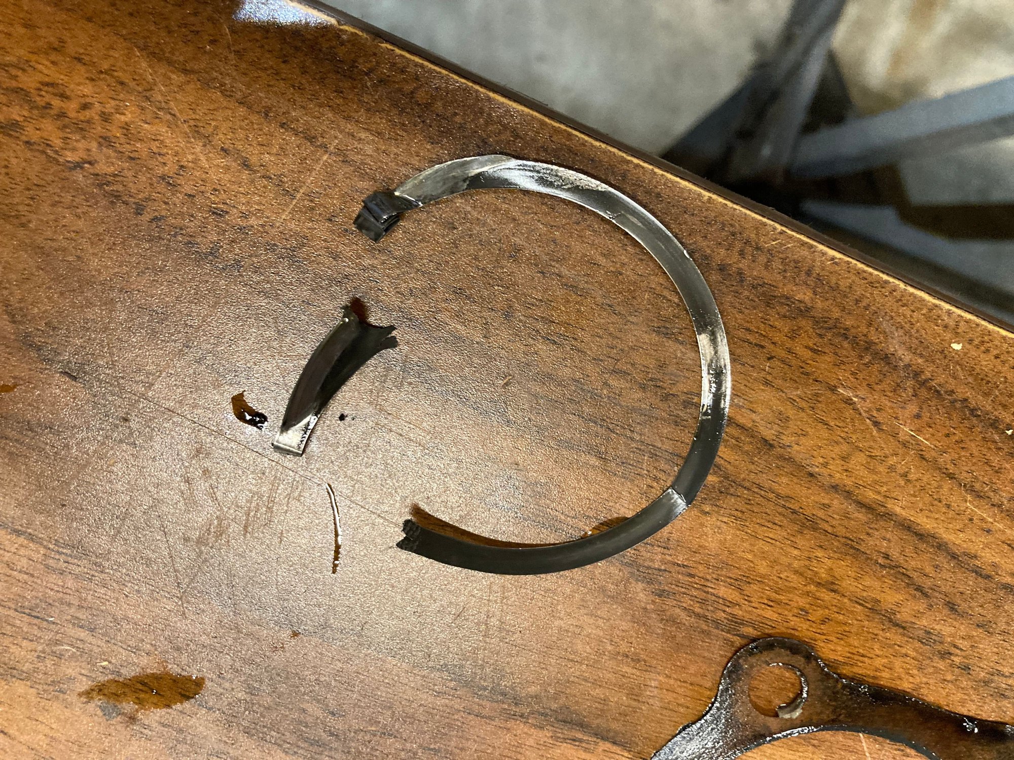

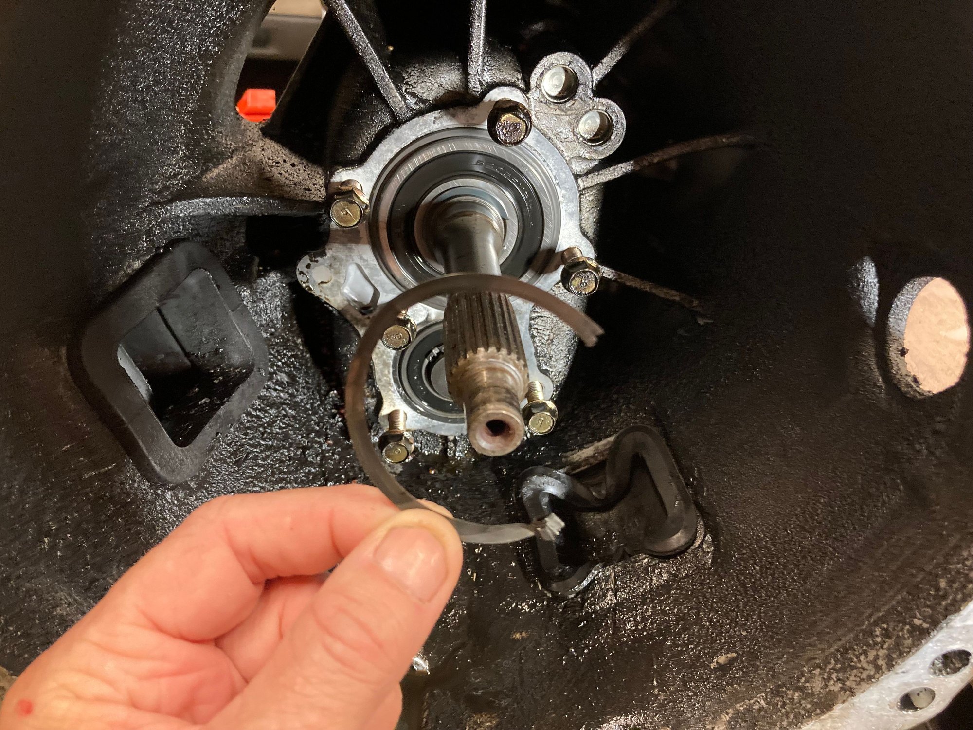

I think it’s a good idea to consider the thickness of the gasket because there is a very thin thrust washer that goes between the transmission case and front cover. Mine happens to be broken as I found it when I removed the cover. The way I see it, a thicker gasket would create a larger gap where the thrust washer resides. That could be a problem. So, whether you buy the correct gasket or make one, its thickness should be as close to stock as possible.
