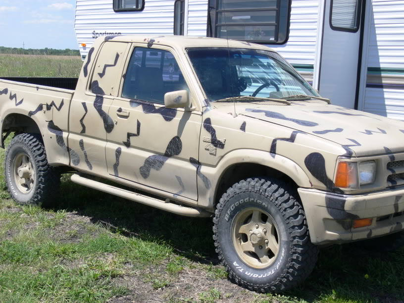

About the only thing i can find for my truck is a body lift and tires. I was hoping someone could help me find a suspension lift. I'm getting a brush guard to put my winch on from a welding shop. I saw mazadab2600's where did you get the ball joint spacers? anyway hopefully you guys can help. Thanks

the bj spacers are made from 1 inch square steel . i heated and bent them around the top of the old ball joints to fit the curve then just marked the holes and drilled them out
i looked at fabtechs design and said its to easy and alot cheaper to make them
mazda's are the upper right corner
its unfortunate but thats about all you will find

i found a Ironman Suspension 2½" LIFT KIT for 87-93 Mazda B-Series 4w its about $350 on ebay. they have about 12 of them.
