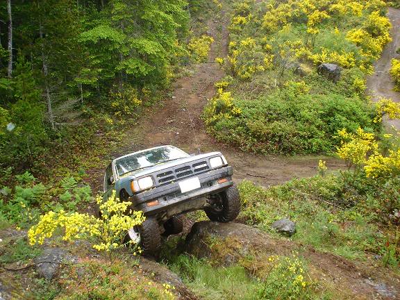

i am just starting on my sas i am using a dana 44 out of an 80 jeep wagoneer with a wms to wms measurement of 61.5" . it now has flat top knuckles, rotors, calipers and manual hubs from an early 80's half ton chevy. i am going to be using rancho 44044 springs in the front
here is the only pic i have of it on 35's it is now under the knife
